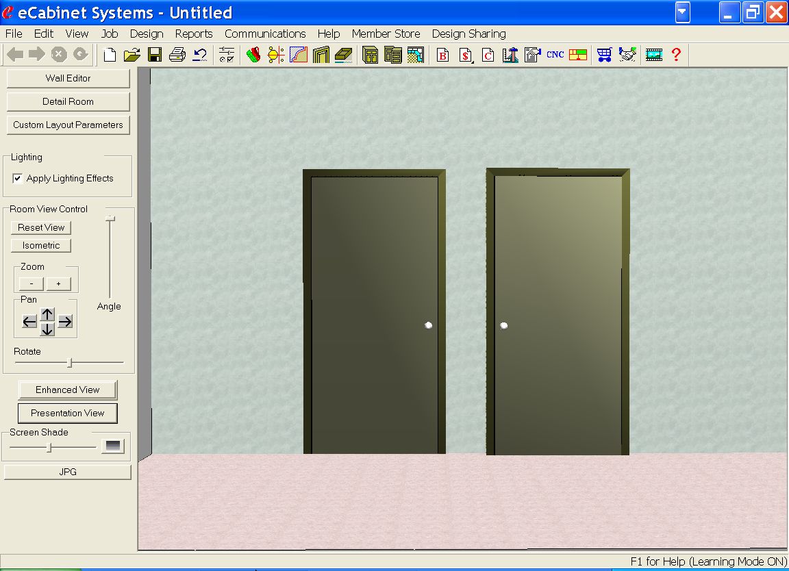

One thing that should work (but it doesn't) is to change the direction for the wall. This puts both the right and left handed doors in place. Unfortunately the door on the right is floating about 4\" from the wall surface and that does not seem to be movable back against the wall.
