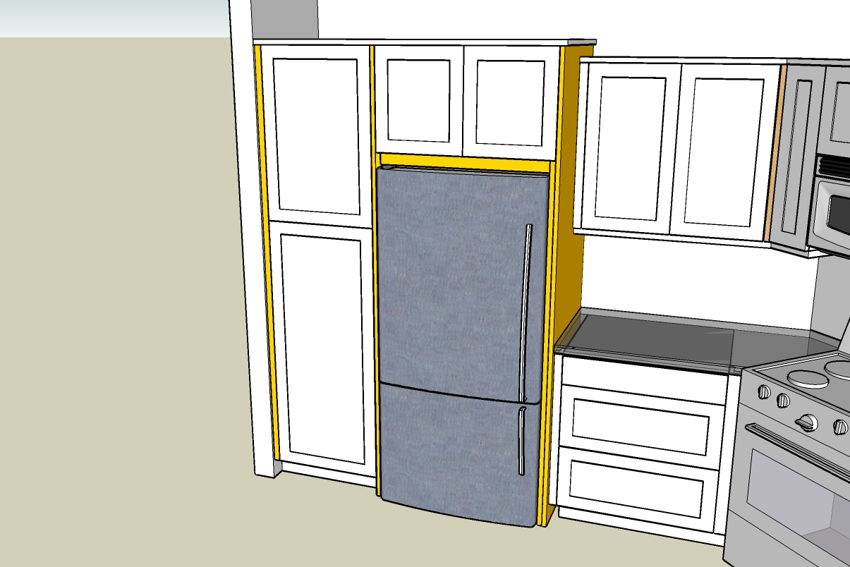

In detailing a room, I am stuck at the point of getting fillers, toekick faces, and the like into the first eCabs kitchen I am building.
See the attached .jpg (a screencap of my Sketchup model) which shows what I am after.
The highlighted parts are what I want to get placed in the room. All can be created as panel parts using the assembly editor, but when it comes to positioning each into the room model, I am stuck.
The assembly editor has the nice alignment tool and method, but there seems to be no such parallel in the room editor.
What am I missing?

Gene Davis wrote:...The assembly editor has the nice alignment tool and method, but there seems to be no such parallel in the room editor.
What am I missing?
1. Select Detail Room, then bring in your panel.
2. Double-click on it to select, and immediately associate to wall -while highlighted, right-click on the wall and associate.
3. Since the panel is selected, right-click | Edit Object | Rotate Object
4. Now, in either normal view or Elevation view, you can place the panel as desired.
Please let us know how this works for you.
Al

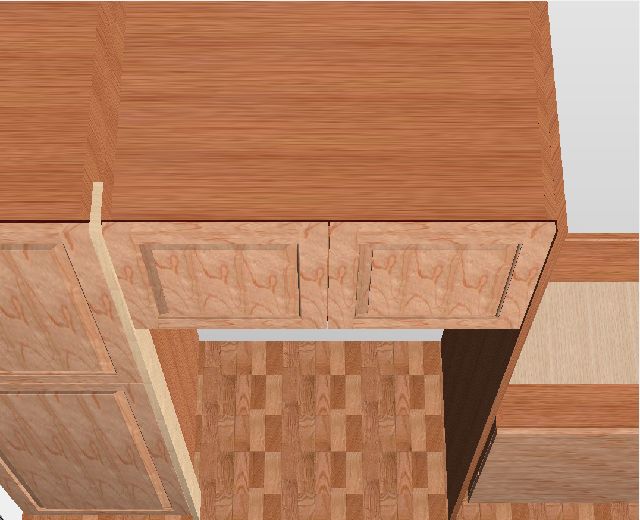

I much prefer the \"align nodes\" feature of the assembly editor for part placement in a model, to the methods I must employ to get stuff into a kitchen room model.
You gotta keep a calculator on the desk, and a scratch pad, to do all the moves, checking first the position relative to walls or floor of other objects to which you want to align the parts.
I can envision it getting even more tedious when doing arrays such as crown moldings and dentils.
