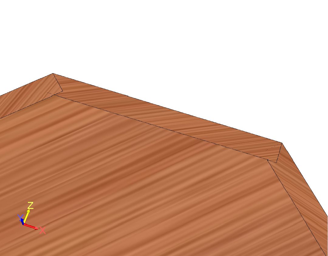

I opened the \"standard\" frameless corner base in the software, and looked at the way the box goes together. In the standard file, the squarecut edges of the backs and back diag interfere.

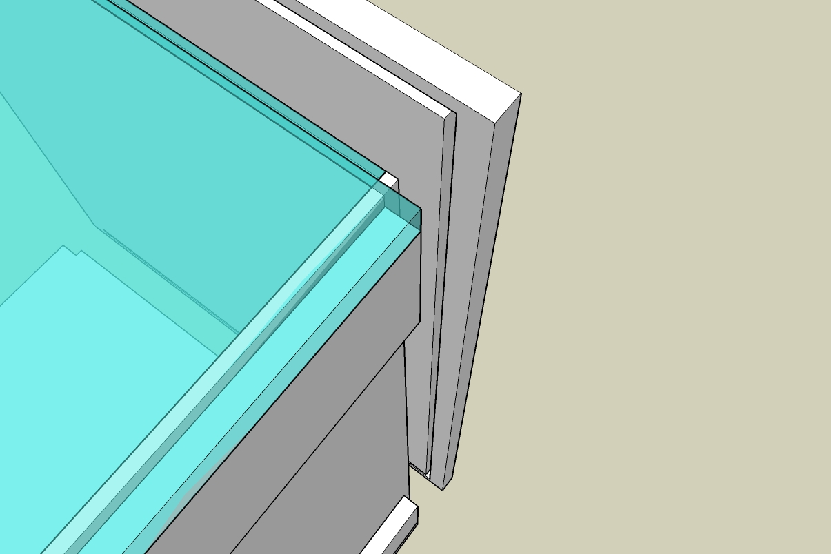

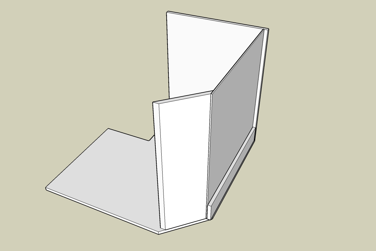

The attached sketch done in Sketchup shows how a susan goes together as furnished by our present RTA carcase maker. In assembly, the top, both ends, and the bevelsawn diag back go together, then the 1/4\" backs slide in, and the cleats, top and bottom, total four, are fastened in place.
I'll bet that the bevelsawn diag part cannot be made on the router. Right?

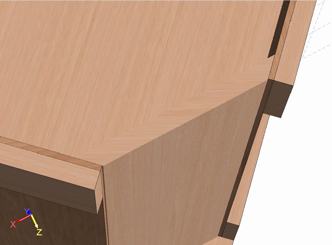

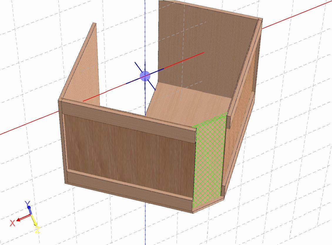

Well, I thought with the stretchers it was going to be relatively easy, but the only way to add a vertical stretcher to the back corner area limits it to the width of the corner gap so it's not wide enough to cut your 45° miters.
But as you can see from the illustration attached a display panel board works fine...be sure to associate it to the cabinet so you don't loose it after saving the cabinet. The display panel will cut out square and you'll have to run it through the table saw...but that really shouldn't pose a big problem.

Looking at the \"standard\" seed cabinet for a frameless susan corner, the backs all meet and interfere at their junctions, but size so that the corner tips match. That all means that it would be an easy secondary whack on the table saw. Set the blade tilt to 22.5 and cut right to the tips.

No Gene the part editor won't add anything to the width...I think for what you're trying to do the easiest thing is to stick with the 1/4\" back set the inset and add the horizontal stretchers. Then simply add the 3/4\" corner as a display panel and rip the 45° bevels on the table saw.
The downside is that when the machine cuts the back it will also cut that center panel of 1/4\" as well...but it's really a small amount of waste if the cabinet is built as you prefer it to be. (I haven't paid attention to the parts list on the controller - but I assume the 3 backs are all considered on piece on the parts list. If not, you may be able to uncheck it in the parts list of the controller and not cut it).

Gene Davis wrote:...the squarecut edges of the backs and back diag interfere...
On corner cabinets, the parts are extended to allow for table saw cutting of miters on these parts but the miters are not shown graphically in the software.

I use corner cabinets all the time and every one I design in e_cabinets will cut perfect every time if they use the correct angle on the saw.
Dan is correct. The software doesn't actually \"show\" the miter but allows enough material to make it on the saw or as a flip-op on the Thermwood.

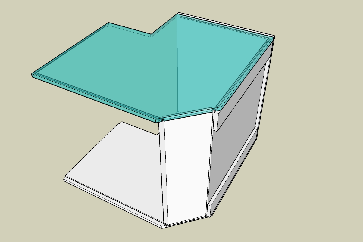

My idea is for the susan corner cab to be built in the way shown in the attached series of screencaps, taken from my Sketchup model.
This model has the top and deck blind tenoned into the sides, and the diag back blind tenoned into the top and deck. Quarter-inch flanker backs slide into full dados, and squarecut stretcher-nailers pocketscrew into place where shown.
Our present supplier of KD cabs has been shipping this model to us for years, and it is strong and light, when compared to one made with 3/4\" backs.
That supplier, however, doesn't cut parts with a Thermwood router, and thus gives us parts with butt joints and a combo of dowel and confirmat screw joinery. We think the M&T will be a nice improvement, and quicker to assemble.
The same design concept is applied to a 24x24 wallcab corner we use, and the 3/4 diag back is prepped with a sequence of 5mm holes at the same vertical centering as the sides, for shelfpins to pick up the adjustable shelves.
We like the relieved-back design, rather than a solid 3/4 back set, because it deals better with wall irregularities at install time.
The 3/4 back with tenoned ends should be able to be CNC cut with squarecut long edges, and as is done with the standard seed corner, edgeripped with 45 bevels on a tablesaw as a secondary shop operation.
