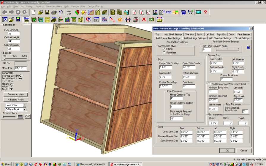

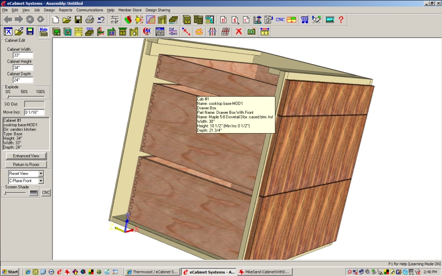

Al,
The issue only shows up in when you use dovetail boxes. None of the cabinets in that job have dovetail drawers.
If you go into the DBE and open one of the dove tail drawer boxes in there, then chang the material thickness to 5/8 you get the error after clicking OK and it rebuilds the box. It will also show every time the cabinet rebuilds after the drawer is added.
I have cut out the job and we figured out the problem.
The dovetail machining properties have to be altered. The set up involves equasions that references the material thickness and the bit parameters.
I am pretty dissapointed in how this is set up in Ecabs. There is no way for the designer to know what bits the shop will use, not to mention the material thickness. Also aparently there are some crucial settings (fit clearance for one) that can only be changed in ecabs. That means the whole job has to be redone, the CNC code generated, and the machine nest as well. This would take an hour (there were a lot of drawers). Obviously the machine operator would not be too happy about spending the time to do that, but there is no way to know that it is OK before you cut them out. All in all the drawers came out nice and I benifited from the conveince of haveing the whole job done at once.

mikesand
Posts: 115
Joined: Fri, Jul 28 2006, 11:53AM
Location: Dallas Texs
Post by mikesand »
That is interesting...
The file that you have is different from the one I machined so the construction parameters aren't the same; drawer insets, and other details.
It dosent seem like that should matter though. On the drawer construction details (in the DBE) what is the % value for the dove tail thickness? That seemed to be the main issue.
Mike
Al Navas
Posts: 443
Re:
Post by Al Navas »
mikesand wrote:...It dosent seem like that should matter though. On the drawer construction details (in the DBE) what is the % value for the dove tail thickness? ...
Mike,
I find for several of the cabinets, although I did not check all of them: 58% .
