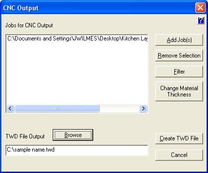

When I try to write cnc I get Invalid file name pop up ? I,m lost

What name are you trying to use?

the file name comes up C:\\document and settings \\ all users\\documents \\v5 test jobCab 1.esj I'm just starting on e cab training guide book so I will have a lot of questions in the next few weeks is this the best place to find answers?

That's the job file it loaded. What is the name you gave in the bottom field?....Be sure to hit BROWSE, then type in the name of the file you wish to create. I attached a screenshot of what it should look like prior to hitting \"OK\".

Not knowing what edition of the workbook you are referring to, I can't tell you what page to reference, but that page is title \"CNC Output\" and is about 20 pages from the end of the book.
eCabinet Systems usings Microsoft file naming conventions, so you can not use special symbols, such as \", ', or /. Those are probably the most common naming errors.
Select the button at the bottom of the CNC Output screen that is labeled \"Browse\". You need to select and the address of where you want the file to go and the file name. If you are sending this to a Thermwood CNC and are connected via a network then your file can go straight to a folder at the machine and would be ready for the operator to load.
