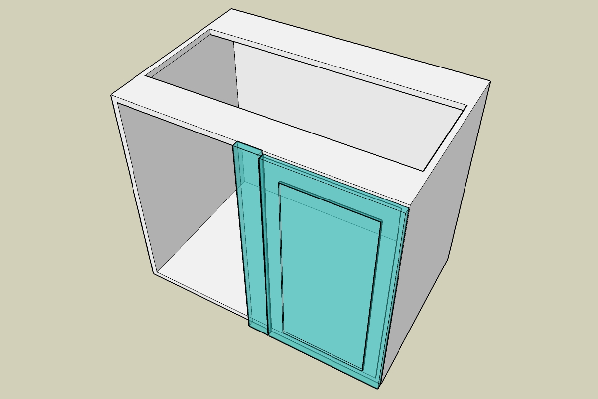

I know how to do the workaround for getting a door to size and place where needed, but is there a way with eCabs to make my seed cab \"parametric,\" and resize as required based on a \"door run\" dimension?
My workaround for getting the door to process is to stick a partition where needed, made from a \"do not cut\" stock.
The door jamb is placed as a display panel.
Frameless blind corner basecab.jpg (160.97 KiB) Viewed 1787 times

Gene,
Place the pilaster as a faceframe with a negative inset. Then place the door inset the thickness of your faceframe with the proper reveals. It should resize.
