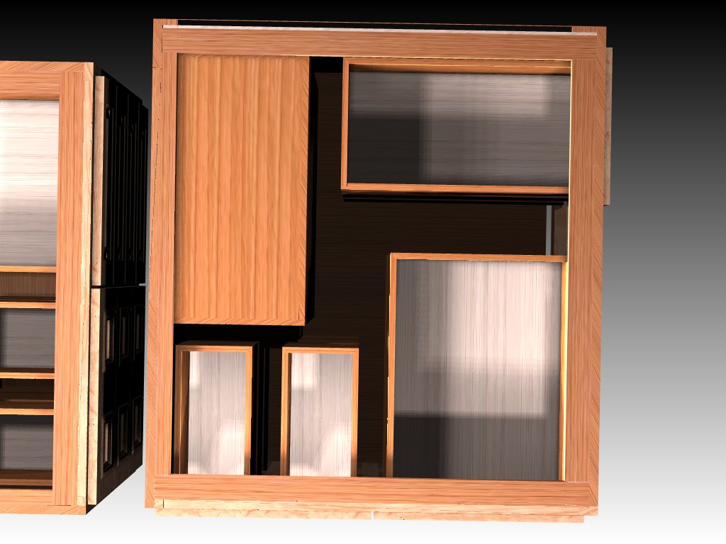

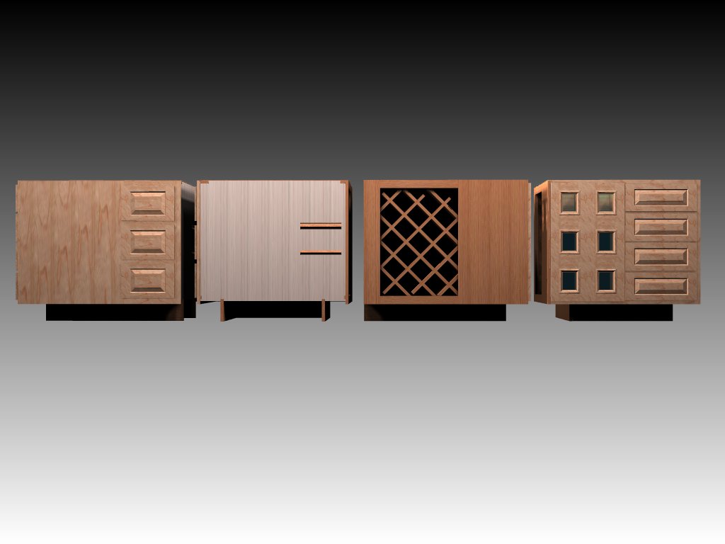

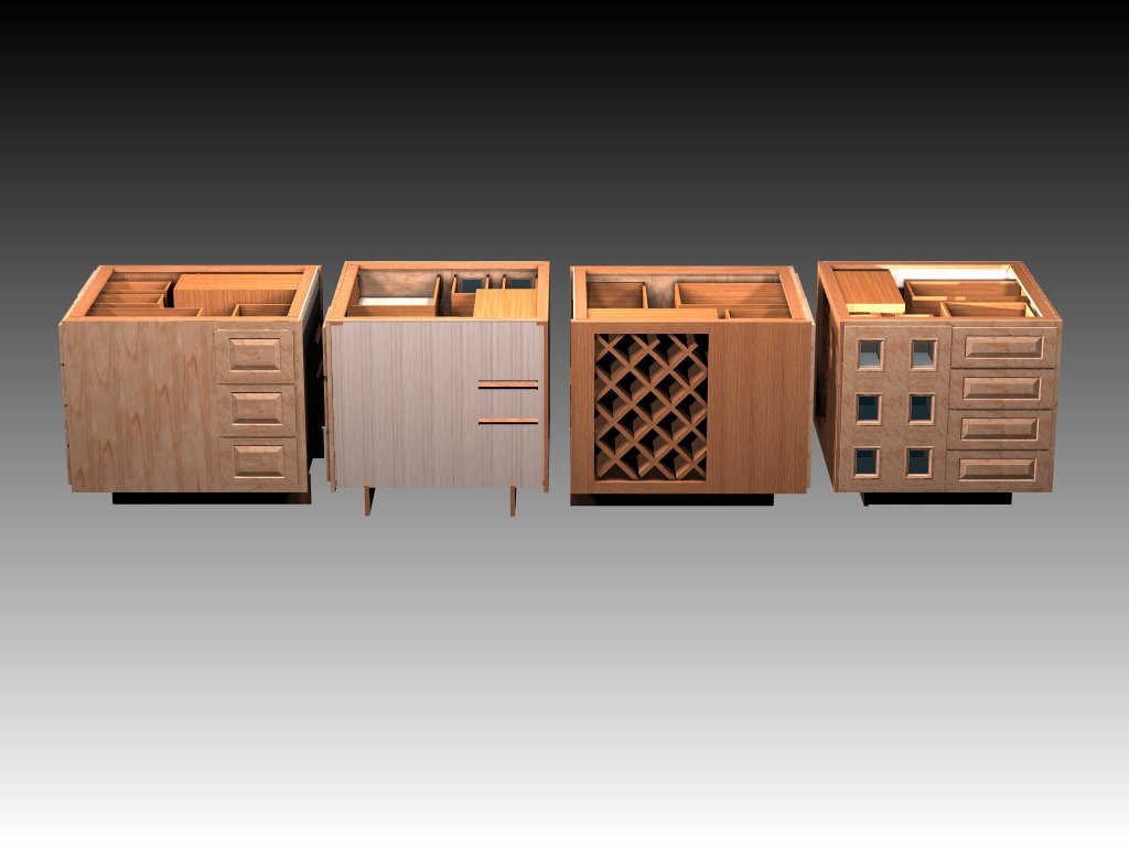

Hi Georgi George here
I was playing with an Inland
The Inland is 3 cabinets
Wine rack is 2 cabinets in side the one cabinet.
Georgi Baltov
Posts: 341
Joined: Sat, Mar 10 2007, 7:31PM
Company Name: Top Notch Cabinets
Location: Oakville, Ontario
Post by Georgi Baltov »
George I made my islands but I used all sorts of pannels to achieve the result that I want. Yours seem to be more complex and created using more than one cabinet inside another. In my case i am not really into the looks of the island itself because I will have to cut that thing on our machine. I see you dont have gables between the drawer boxes. So my guess is it's all separate cabinets and then you alligned them together to achieve the looks but that doesnt really help me. Anyways if you could give me a clue what technique you used may be I can use it next time I have to do something like that. Thanks man
