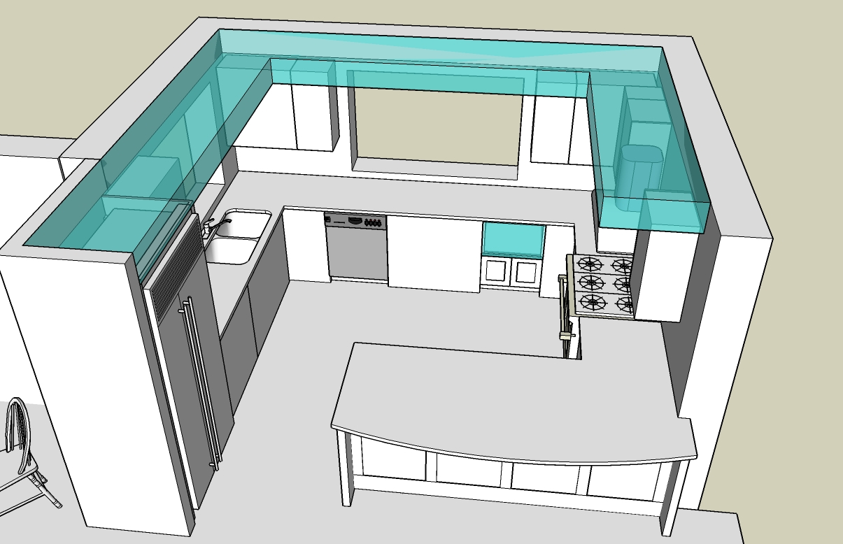

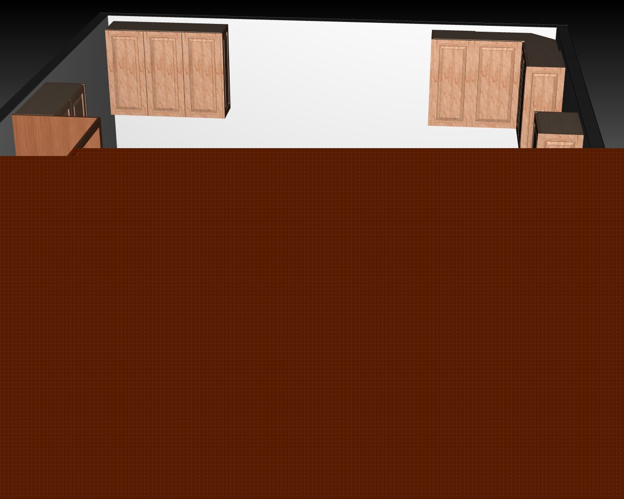

I'm having little fun trying to model this little kitchen-in-a-pocket. Much much easier in Sketchup, except I can't cut wood or buy components from a Sketchup file.
Any hints on a way to model the stile and rail peninsula wainscot face panel?
Tedious pocket.jpg (40 KiB) Viewed 11731 times
Sketchup pocket.jpg (293.96 KiB) Viewed 11744 times

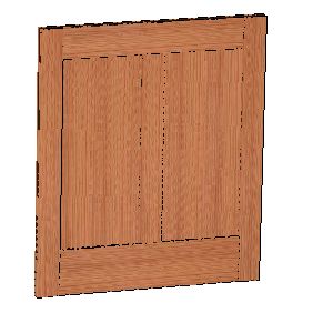

This works pretty good as a bar back Gene.
bar back.hsf
(146.02 KiB) Downloaded 816 times
bar back.jpg (13.89 KiB) Viewed 11783 times

Maybe I'm missing it but seems you could use a face frame cabinet turn off everthing except the face frame and make it how you wanted.

Alan, That's exactly what I did on my last post. A face frame cab with no sides, top or deck, 1/4\" face frame material, 3/4 back and the cab depth set to 1\".

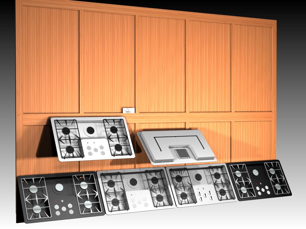

George,
Here is one of the G E files.
Thanks for taking a look at it.
r02687v-1.zip
(462.6 KiB) Downloaded 815 times
G E Gas Range
Hi Kerry
I could not get it to work
So I made my own :?:
There is NO! returns
If you take it from the show room
Range_Gas.zip
(333.65 KiB) Downloaded 863 times

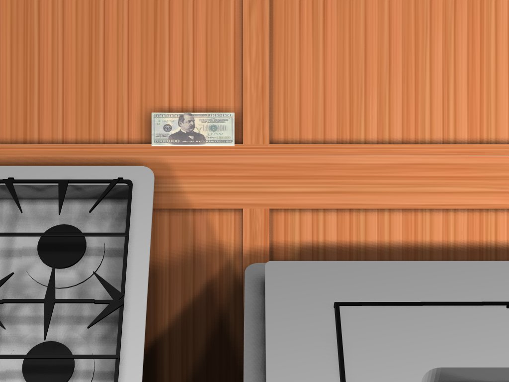

Hey George,
There are a few of us power users out here, and if you shared that million dollars on the wall it would make our lives much more complete. What do you say? Share the love? :P
