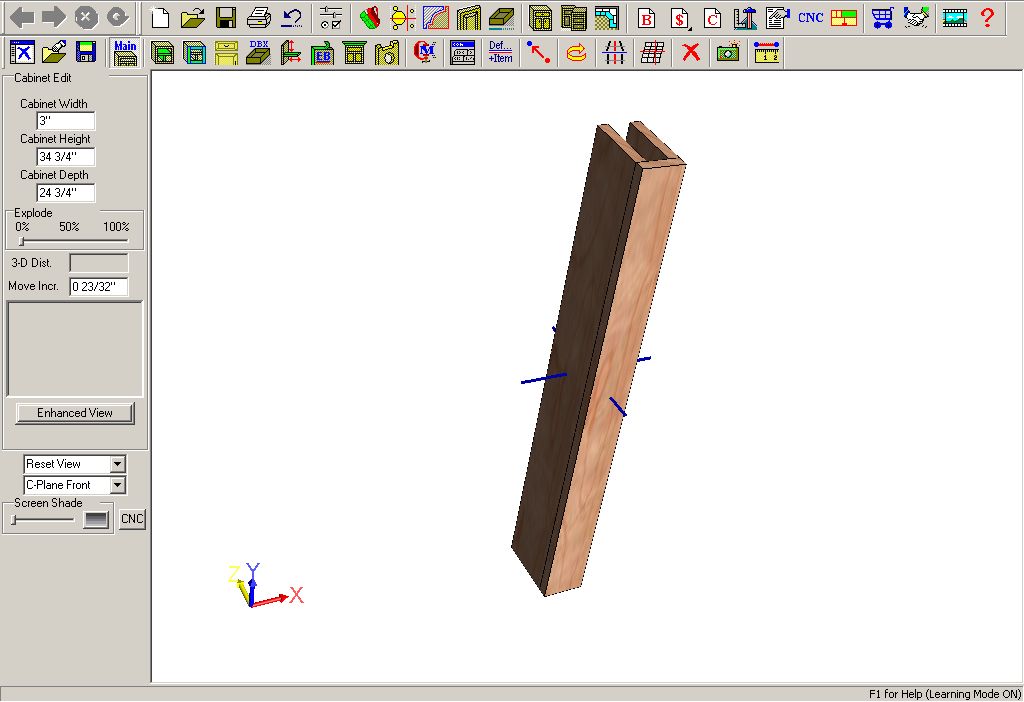

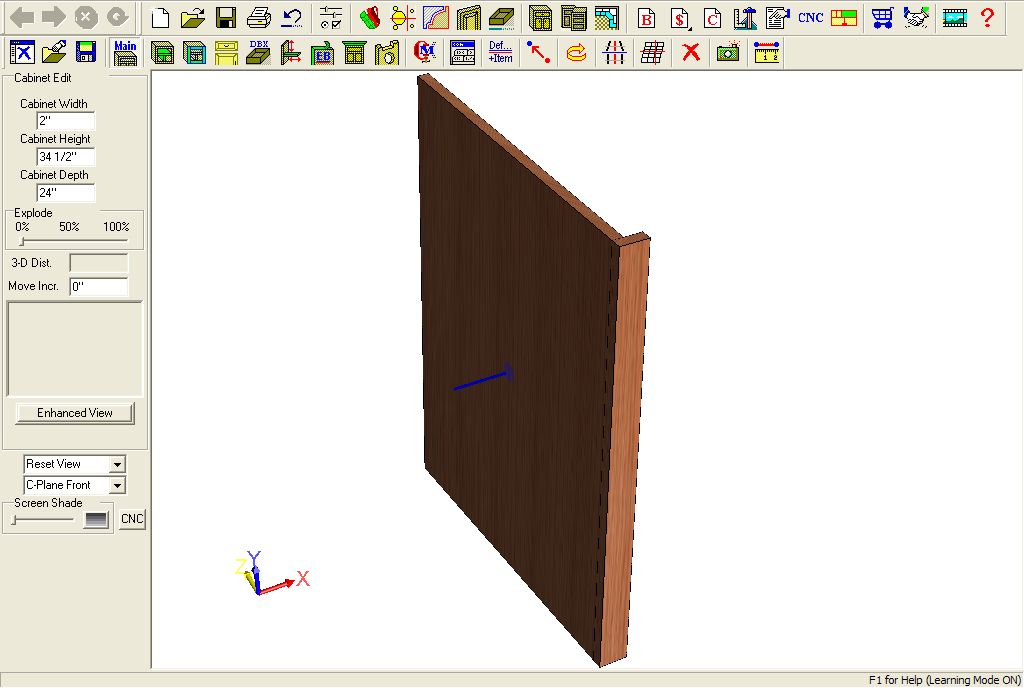

Most fillers that I develope are a left or right end with a left or right stile of the face frame. I save the filler the width it should be. You may want to do a detatched toe kick so the face frame does not go to the floor. Depending on the look you are trying to get.
Take a look at a few here.

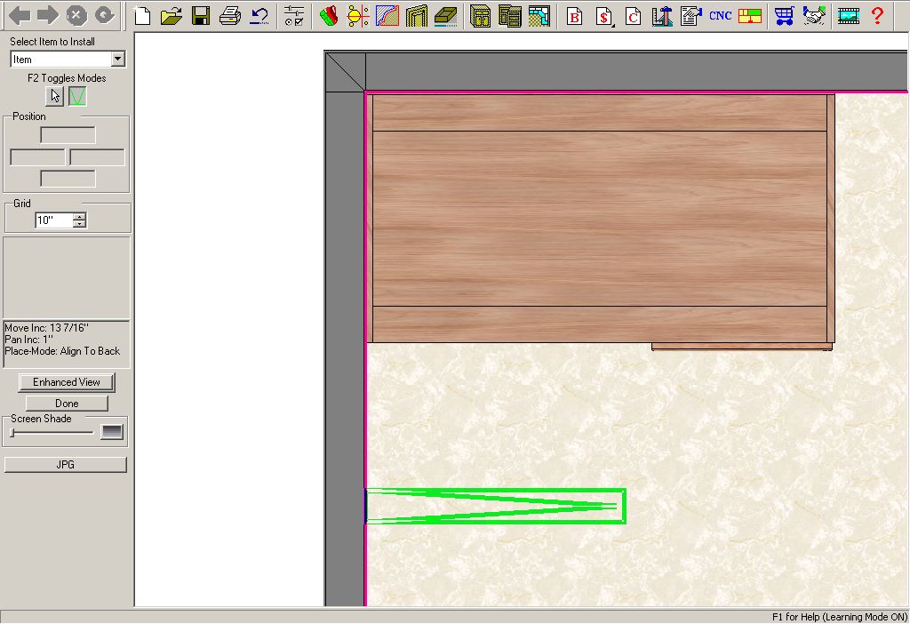

And speaking of that, which is easier?
Popping the filler onto the cab in the cab editor, then taking the assembly into the room?
Or instead, taking a filler into the room after the cab is placed, then using this &@$%@ software to move it into position?
Sorry. ECabs is about ten generations behind other packages when it comes to moving and aligning miscellaneous stuff (boards, etc.)

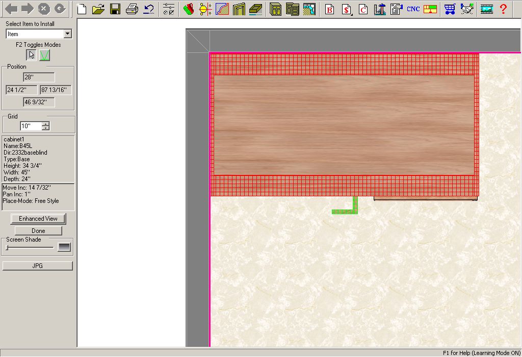

I have no problem whatsoever moving items around. I would insert the filler and align in free mode.
I usualy have a blind corner and place a filler next to it to continue the run.
It is a matter of addition and subtraction in formula to move the items around.
Look at the progression.

The filler was 38 7/32 away from the wall the blind cabinet is against. I want my filler 24\" off the wall. so (38 7/32)-(24) = the distant I need to move the filler in free style towards the blind corner.
This will position the filler exactly where I want it.
By the way my filler is a cabinet saved as 23 3/4\" deep but I did an inset on the end panel to make the side 3 1/2\" deep. When I set this cabinet it will set the filler at 24 3/4 out where I need it.
That's why it has an L shape

Take a standard cabinet, remove the back, right end, top, deck toe kick set to \"no toe kick\" If that's your prefference, shelves and anything else except a left end and left stile. You have to click on the right stile top and bottom rail and hit delete. You don't put \"0\" in the values.
This is what you should have.

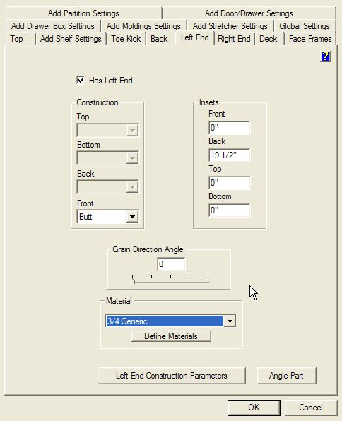

Here is a the file if you want to take a look at the settings.
Normally I inset the back 19 1/2\" this makes the side of the filler actual size of the filler 5 1/4\" deep. But, leave the depth of the cabinet itself at 24 3/4\" deep to allow the face frame to line up with the front of the door.
