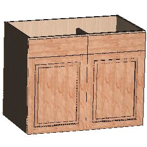

Here's my construction of a kitchen sinkbase. It has partitions that define the two false drawerfronts above the doors, made of material titled \"Do Not Cut.\"
They are the workaround for getting the openings for defining the drawerfronts. What is there also, is the blind-tenoned stretcher to which the drawerfronts are fixed with screws from behind, and the drawerfronts will stand a little proud because we will install them with the same 1/16\" soft plastic bumpers we use for all doors and drawerfronts.
We want simplified construction. No tip-out hardware for the drawerfronts. They will be fixed. Period.
The dilemma is the color of the stretcher, and how it will not match the fronts. We do all our frameless jobs using maple melamine, thus that stretcher will be maple.
Our top reveal is 3/8\", and while it will be in the shadow of the overhanging countertop, the plumber, or anyone bending low to get into the cab, will see the maple surface. Likewise for the horizontal margins between drawerfronts and doors, plus the vertical one between the drawerfronts.
This stretcher is the only piece in the whole kitchen with this \"can see it\" feature.
What solution is there that is cost-effective?

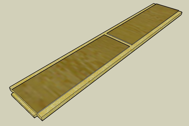

I may have an idea, albeit a silly one.
Here, rendered in Sketchup, is the front stretcher, cut in the nest with 1/8\" deep x 3/4\" width plows, each to house a thin strip of finished wood in the species and finish of the fronts.
Those strips can be placed and fixed with contact adhesive, and voila! Problem solved.
Any other ideas? I'm open.

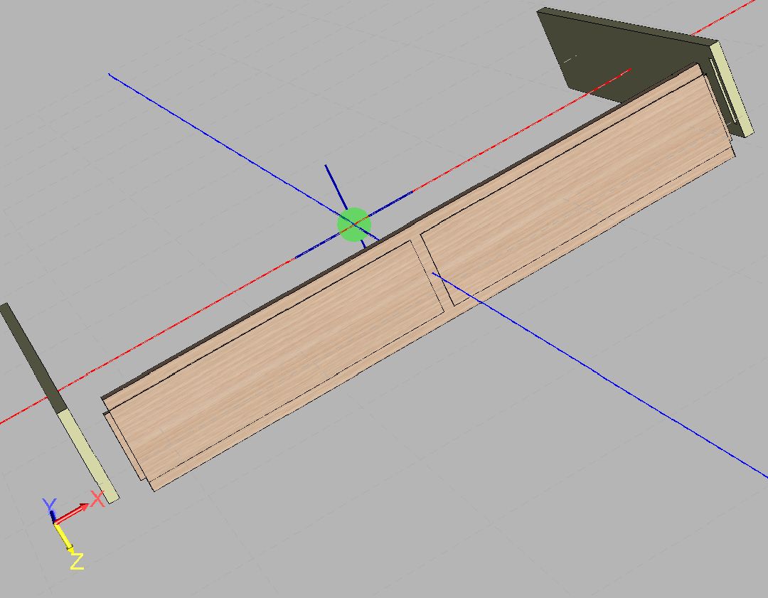

I did it another way, Justin.
I built a frameless cabinet 7\" deep, same width as my sinkbase, no back, no top, just a deck and two sides. Seven inches is the width of the stretcher in the sinkbase, and that stretcher has tenoned ends. The deck of this \"workaround cab\" is blind tenoned into the sides, and the sides are made of DO NOT CUT material the same 0.765 thickness as the mel we'll use for all the carcases in the job.
Thus, the deck of this \"cab\" matches the stretcher in width, length, material, and its end tenon detailing.
As you can see in the pic here, I took the deck of this cab into the part editor and did the .125 x .78125 routs. This \"cabinet\" was added to the room, and should yield the stretcher part I need for my 46-inch sinkbase.
I hope this works for me.

Gene,
I rellish the idea. I do have one question. How will the blind dado be cut into the sides of your cabinet to recieve this part?
Is this a seperate cabinet to produce this part?

Michael Y, the part-edited piece is the deck of a separate cabinet, and that cabinet only has its deck cut. As it turns out, doing this workaround results in two parts for the stretcher, the one in the actual sinkbase (which is needed to get the mortises in the L and R ends), and the routed one that will be substituted.
Michael M, thanks for the magic marker idea. We'll go ahead and cut this with the extra stretcher with the inlay plows, but if the magic marker thing looks OK, we'll dispense with using the detailed front, and instead use the plain one, done up with the marker.
