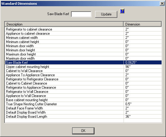

Question for you saw shop guys: Does \"COLLAR SIZE\" relate directly to kerf width, when nesting using true shape.
If so, and you are using a rip blade with 0.133\" kerf, do you then set you collar size to the 133?
Gene,
You wouldn't want to use \"True Shape\" nesting for a shop not using CNC. This type of nest would not have \"through\" cuts to make it practical for a saw shop. The yield is better using \"True Shape\" because of the capabilities of the CNC Router.
I set the collar at 0\". The kerf is set in the Standard Dimensions area of Settings and Preferences.
Standard Dimensions.jpg (61.42 KiB) Viewed 13311 times
Here is a little more from the area help docs:
The Collar is a band around the entire edge of the sheet into which parts will not be nested. The Collar can be used to allow for slightly off sized sheets or a small amount of edge damage.

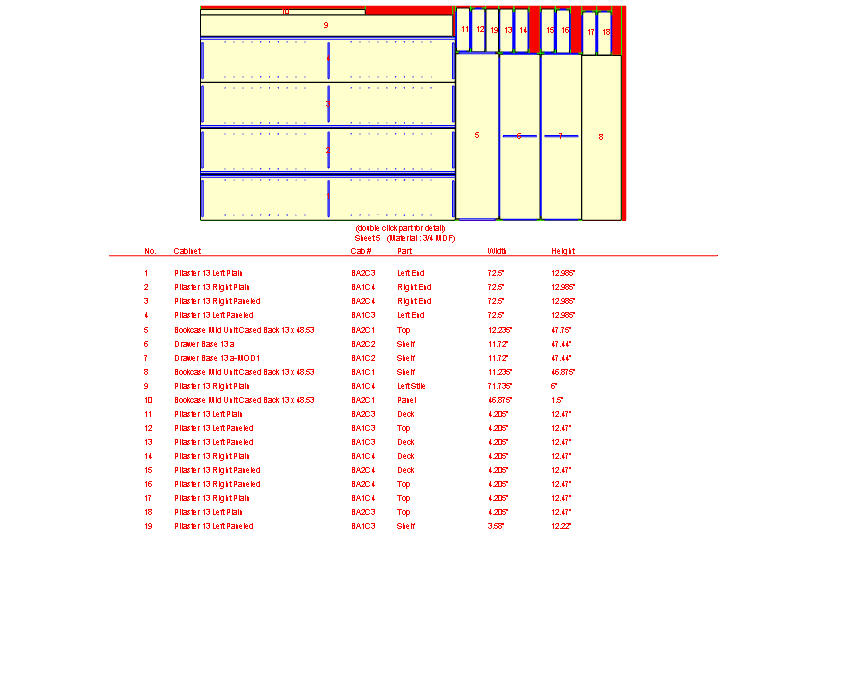

While we are on the nesting of ecabinets, it would be good if the nesting algorythm could rotate parts independently when nesting. I have found that with some jobs by rotating a few items on a sheet 90 degrees I can squeeze a job out of one less sheet.( I get this by running the panels required through a different sheet nesting package) I know you can switch between vertical and horizontal but that rotates all the pieces on a sheet and does not take advantage of saving only rotating a few pieces can achieve.
If you have \"Grain\" checked on your material Glenn, nesting won't rotate the parts regardless of the nesting orientation.
here's an example of mixed rotation nesting of parts without grain.
