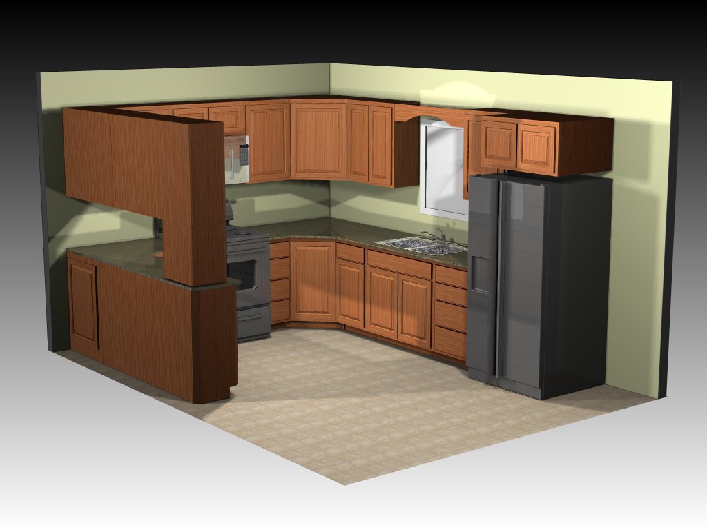

Post by Tony Marrazzo »
Worked like a champ! One more thing, when I save JPEG's for posting, what size should they be so it doesn't mess up the view (so you don't have to use the slide bar on the bottom to view pics)?
Newcomb 1.jpg (79.92 KiB) Viewed 6814 times
