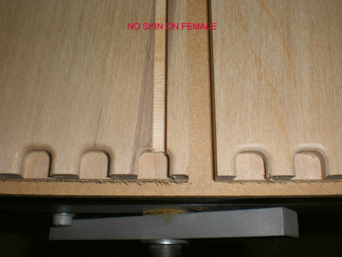

OK, I Just resurfaced the spoilboard and reset the switchspoil value, put on a new waistboard, measured it and changed the settings to reflect thickness. Remeasured all the tools.
I cut a batch of drawers and the male pins still have the skin ( maybe a circumcision would help :lol: ) The other parts cut fine. I adjusted the cut through thickness and run the program again to see if it would make a difference, but it didn't. I would think maybe the daylight is off on that tool, but I measured it.
Any ideas?

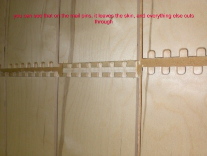

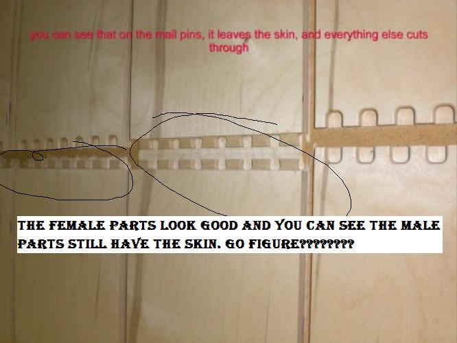

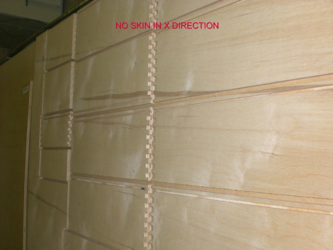

Mike, I only surfaced one side of the waist board. The only areas that did not get cleaned up are the male pins. You can see in the pictures that everything looks good except in those areas. This is a 5 x 5 sheet of baltic birch with this problem scattered all over the sheet, only on the pins though.
Normally though, when I cut drawers, the score marks in the waistboard are deeper, than when I cut cabinet parts for some reason. I peeked under one of the parts this morning (I have not moved them, I was waiting for someone to respond) and the score marked are very shallow. I am going to set the cut through depth a little deeper and run the tool over them again to see what happens. :wall:

I corrected the problem by adding more cut through depth, but you get a deeper score mark in the waistboard on the male pins vs the female pins. They are not the same. You can look at the waistboard everywhere they cut and the cut through depth is not the same on male vs female.
