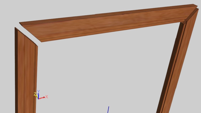

Tony,
Here is a frame done as a display object. Copy and past both the .jpg and .hsf file in your eCabinets/import file. Make sure they have the exact same name (the forum adds numbers to the file name.) You can then open it in the cabinet editor or place it in a room and highlight it then choose Scale Object and make it any size you want. You can also use match texture to change the look.

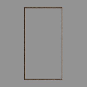

Starting with a standard frameless base cabinet, I added 2" face frames from sheet stock (you can use board stock too). Then I removed all other cabinet parts so all that remains is the face frame.
Next I took each part into the Part Editor and, using the chamfer tool (1 distance = 2"), I mitered the ends.
The next step I performed was to apply vertical constraints to each end of each part so the miter would stay put when the part is resized.
Then I applied a profile to the WRONG EDGE (i.e. outside edges instead of inside edges) and inset it 1 3/4" in the opposite direction (so it would be on the inside edge). For example if the long side of the part was on the left, I made the tool path on the left and inset it RIGHT 1 3/4". This has to be done in this manner to prevent a "stopped" profile on the inside mitered ends.
The result? A resizable, mitered and profiled frame. :beer:

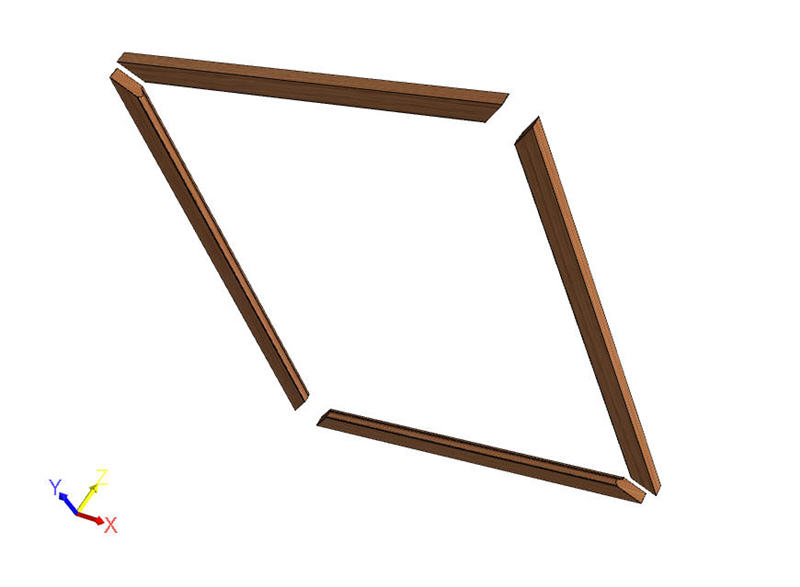

Here is the same frame but with a 4" bottom rail and rabbets on the back for the mirror.

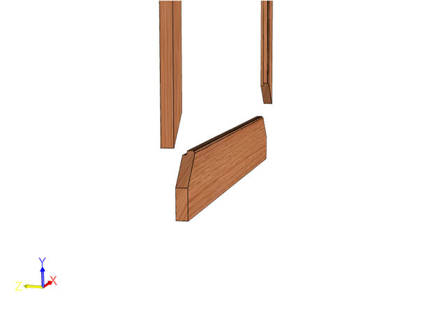

Tony,
You can use Dan's face frame method and just create a bead tool.
This is using a 1/4" bead tool with a 1/8" quirk.
