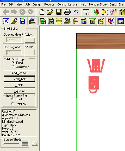

I've got an interesting bug happening, wondering if anyone has a solution. It's not critical on this cabinet, but could be in the future.
Trying to add a center fixed partition. (I had one originally, tried to move it slightly after other changes, I couldn't highlight it or anything. I was finally able to highlight it and remove it, and thought the problem was solved, but no).
When I try to highlight the opening of the carcass in partition editor, I can't select an area. It just won't. Can someone else try it and see if it's ecabs related, or some sort of cryptic ghost in my computer just trying to make my day more difficult?
In my job, it's part of a larger assembly, but I saved this cabinet separately, and it does the same thing whether I open just the individual cabinet, or the full assembly. I closed down ecabs and restarted it, but it still does it.
Darrel

Re: Myster Partition
That's a good one Darrel. I even tried the old trick of turning face frames off and back on but it didn't help.

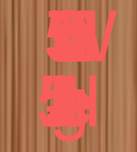

I kept seeing these two red blobs at the top left of the cabinet when in the Shelf/Partition Editor (first image). After zooming in very close, it looks like several numbers and letters stacked on top of one another (second image).
If you can figure out what these are and how they got there, I'll bet it will solve the mystery for you.

Those are numbers in red-----before I was able to delete the partition, there was a listing of what kind of looked like measures along the upper right half of the cabinet....weird and I'd never seen them, and it wasn't quite measures---or at least it didn't read like measures (a strange mix of numbers and letters. On the left half of the carcass was another set of measures--more like what you usually see in ecabs (kind of like the box that states how wide and how tall an opening is). I wish I had saved that cabinet before I deleted the partition, because it was an interesting sight to behold. It might have given more info to figure out what was causing the whole thing.

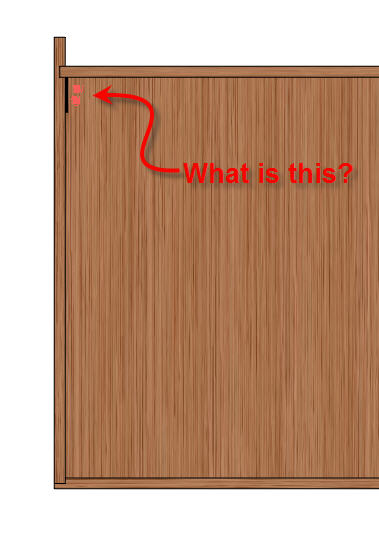

Okay, I got part of it figured out. If you remove the top and put it back, the red numbers go away and you can select the opening. BUT the opening does not extend completely across the cabinet...only about 3/4 across.
The red numbers are the contents of the opening size tag shown in the Shelf/Partition Editor but without the surrounding box.

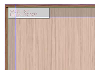

Not so fast there Todd...if you got the same thing I did, the opening is only 29.25" wide instead of 57.75".
I was able to add a partition after removing the top then adjust the left opening width. No matter what I changed the left opening to, the total of both openings went to 128.5" and the cabinet is only 58.5".
Look at this after adding a partition when all other parts have been removed.

If I remove all parts via CS then go into Shelf/Partition Editor, I have a dimension box that says Width = 29.25" Height = 31". Do you not get that when you first remove everything?
