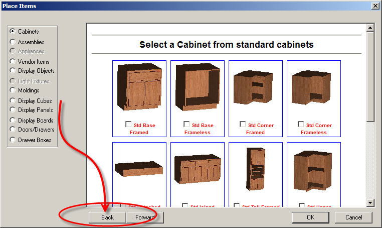

I creted a new directory, saved my cabinet in the new directory, but when I come back to open it later, there is nothing there.
If however I look through my computer, in the C drive / Programs / Thermwood / Cabinets , I'll find my folder and actually see an image of my cabinet in a small viewer.
When I installed the eCabinet CD onto my computer I saw a brief error message saying that Adobe Acrobat Reader was not installed correctly.
I'm wondwring how that may be effecting my program and is that Adobe Reader critical to the system.
Should I re-install the CD again?
Aaron
Re: How to save my cabinet designs?
If the Load item dialog is showing Standard Cabinets, click the "Back" button then select the directory you just created.
load Item.jpg (77.5 KiB) Viewed 5590 times

Hi
OK, that works, thank you for the tips.
