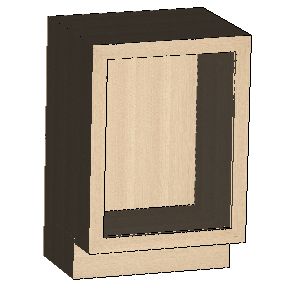

I'm trying to create some plain boxes that will be finished all the way around, and would like to miter the corners together. How do i go about it because the only options it gives me on cabinets is butt, dado, etc, but no miter option.If it requires going to the part editor, I need real easy instructions, because I've had no luck in figuring out that part of the software. Thanks, Lee.

Lee,
You want to miter your face frames to the cabinet sides? If 'yes', then you'll need the Part Editor. I can certainly post a method for you if you wish.
Mike

Lee,
I'm attaching a cabinet with everything mitered, along with the tool I use in Part Editor. For now, I hope you're good at reverse engineering. :wink:
I don't have time to fully explain right now, but here's a few tips:
All of your cabinet joints should be set to 'Butt'
You'll need to make sure that all of your cabinet parts and face frame parts overlap before you start mitering. (Check my inset settings on all parts.)
You'll have to 'flip' most pieces before running the tool on them.
The tool needs no offsets or depth adjustments.
The rails and stiles need the tool file for the miter to join the cabinet carcass, but need the 'Chamfer' tool from the 'Part Editor' itself to miter to each other.
Hopefully I'll have time over the weekend to show you step by step.
Feel free to PM me.
Mike

Mike Seisser
Posts: 544
Company Name: NCB Inc.
Re: Miter joints
Post by Mike Seisser »
Lee,
Go to Construction Settings.
Click on the Face Frames tab.
Set your Top Rail insets to -2 (both left and right)
Set your Bottom Rail insets to -2 (both left and right)
(Note: This is assuming standard width stiles and rails of 2" - if you are using a different width, adjust your insets accordingly)
Click 'OK'
Select the Top Rail by single clicking on it.
Enter the Part Editor.
Choose the Chamfer tool from the toolbar. (6th tool from the left)
At the bottom of the screen, select 1-Distance
Enter 2" in the resulting dialog box (to the right)
Hit Enter
Select the end labeled Right with the selection box, then the unlabeled bottom edge.
Select the unlabeled left end, then the unlabeled bottom edge.
Click Return
Click Yes
Rinse and repeat for the bottom rail, left stile, and right stile.
Mike

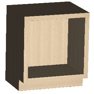

Lee,
Try this instead.
Lee Miters 5.1.hsf
(1.01 MiB) Downloaded 891 times
Lee Miters 5.1.jpg (11.84 KiB) Viewed 12051 times
Mike
