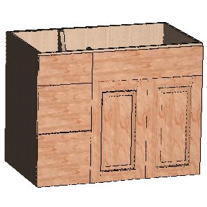

The file attached here is one depicting a frameless bath sink vanity. A false drawerfront atop two drawers, and one atop the paired doors, makes drawerslide holes inside for slides, where none are needed, or wanted.
I first placed these "drawers" leaving the "has drawerbox" selection unchecked, and this happened. I've placed a lot of false drawerfronts in cabinets and this is the first occurrence of unwanted drawerslide holes appearing.
I saw the holes, then went into the door/drawer editor, selected each false drawerfront, re-checked to see that the "has drawerbox" box was unchecked, then said "OK". Regenerations put the hardware holes there again.
I then went into the door/drawer editor, selected both false fronts, deleted them, and put them back in, without checking the "has drawerbox" selection. Same results.
What is going on here?

When using drawer boxes with drawer fronts, slides are associated to the front. (this is a hangover from the days before eCabinets showed drawer boxes. You will have to remove the default slide in Define Items and place the false front, then add the default slide back and place the other three drawers to get the correct holes. Once you have done this to your seed it will work correctly. It would be better if the slides were associated to the box as they are in the drawer box editor.

When you selected your hardware, you associated it to the drawer fronts and not the drawer boxes. So any time you add that drawer front it is going to have to hardware holes associated to the drawer. Now if you only associate it to the dbx then it will only add the slide when the dbx is added.
