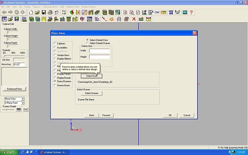

Leigh,
After selecting Doors/Drawers in Place Item click on the Select Door Button to open up the Door Drawer Editor to select a door you have created.

Re: Placing door:
Post by leigh mills »
yes this is what i have done, it only lets me open the satndard doors and not the ones in which i have created

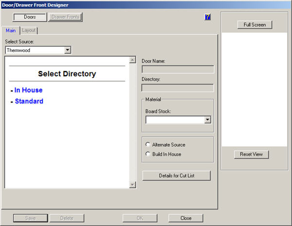

You don't see something like this?
door selection.jpg (34.84 KiB) Viewed 5921 times
You should be able to find any door you created by browsing to the directory you saved it in.

Re: Placing door:
This is what i get yes. i then select the door that i have saved and then it is shown up below select door in the door drawer option, when i then click ok it says select a door, which i already have. But when i select another door which isnt located in my own directory it will be loaded up.
