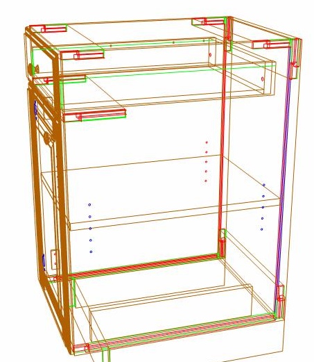

I would really like the ability to make the tenons of stretcher and nailer parts asymmetrical, to enable the idiot-proofing of assembly work.
Please see the image here.
What is the workaround? I cannot find a way in eCabs.

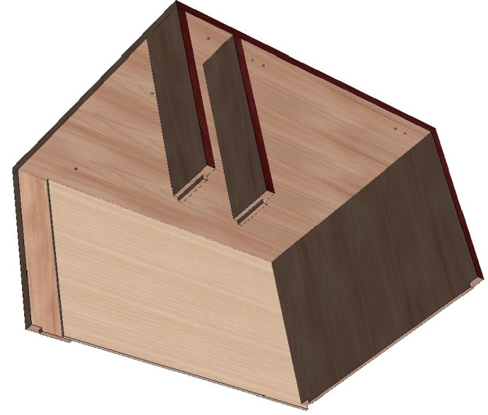

And here is a pic of the result.
A working model of a "minimum material cost" basecab that is easy and fast to assemble, with a little idiot-proofing embedded in the parts design.
The 6mm back slides into full dado slots from the bottom.
