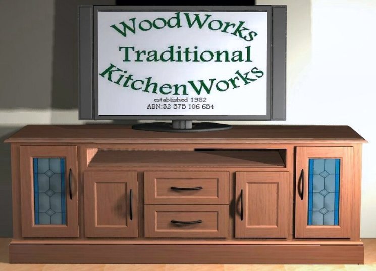

You can certainly do what you want by copying the JPG to C:\Program Files\Thermwood\eCabinet Systems\materials\ImportedImages.
After you copy the file to that location, you will want to create a display cube of the size you need and select an image to display on it. You will want to experiment with tiled and stretched versions of the image to see which gives you the best results.
Here is an example using a screen capture of one of the eCabinets dialogs for the "inlay." I used a 12x12x.25 display cube and stretched the image on it. I moved the display cube into location and associated it to the cabinet--this is important...if you don't assiciate to the cabinet, the display cube will be lost when you save the cabinet.

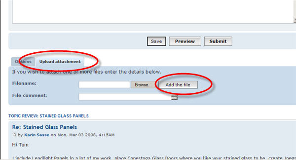

Just click the "Upload Attachment" tab below, browse to find the file you want to upload and click the "Add File" button. Make sure the dimensions are no larger than 800x600.
You can also place the image within the body of the post (as I did here) by clicking the "Place Inline" button after the file had been added.

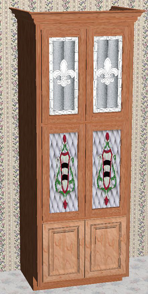

I'm attemptimg to send you a bit of my trial run.
Tom
Tall Cabinet with Bevels & stained glass.jpg (191.24 KiB) Viewed 6084 times
Re: Stained Glass Panels
Looks like you got it figured out!
There is little you can't accomplish with eCabinets. Sometimes you have to be pretty creative in your thought process but you can usually get the look you are after.
