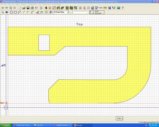

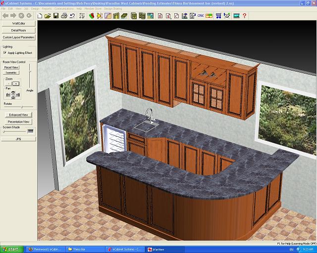

OK.. Did that.. I had to redo the other part editor cuts. This time I did ALL the part editor cuts to the countertop at the same time including the sink cutout.
when going back to detail room I get the Message "Cannot find countertop body" ... I Click OK ... It then returns to detail room.. However the sink cutout does not show up when in detail room or the main room layout screen ( Pic attached ). This time it does allow me to go back to part editor and the Sink cutout is showing up here ( Pic attached ). I notice when highlighting the countertop in Detail room the sink area does not go green with the rest of the countertop.
I am able to select the sink cutout area seperatly and delete it from Detail room. Then when I take the countertop back to part editor the sink cutout does not show up anymore. This is definatly strange.. Wait a minuite.... Now I try to take the countert back to part editor and It is back to giving me the same error messages and will not allow me to go back to part editor without loosing the other cuts again...
