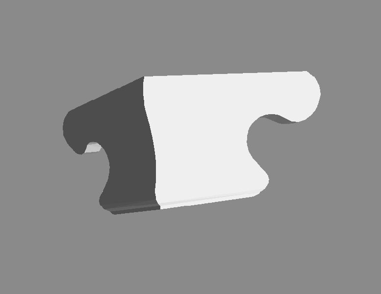

Kerry here is one of the feet ( Corner Ogee Foot ). If you need to down load it you will have to talk me through it I don't know how to get you the file.
Corner Ogee Foot.jpg (13.12 KiB) Viewed 16000 times
Re: How do you price ?
Post by Gary Puckett »
Kerry,
When I bring the foot up in cabinet editor and run a cost sheet the cost shows up, but when I bring the cabinet to the cabinet editor and run a cost sheet the feet are not there. I have tried associating the feet to the cabinet and it won't let me. When I add feet to a cabinet I have to save it as an assembly, right ?
