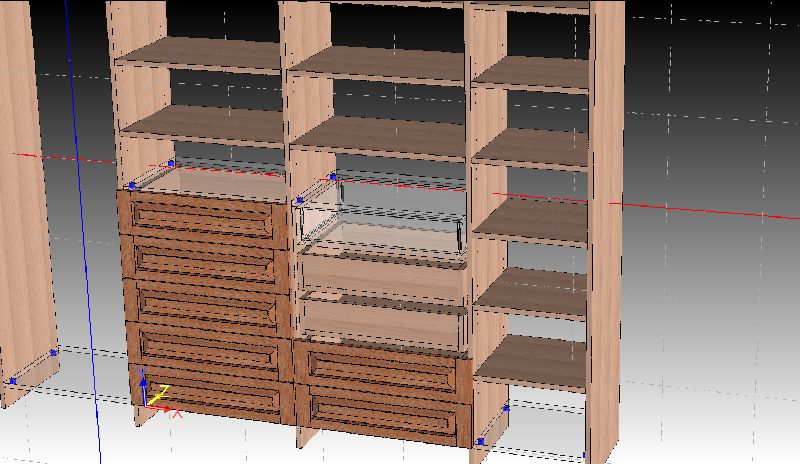

John, the Thermwood machine will do all you need. Something to consider is you do not need to bore full rows of holes. The ecabients software will put holes where you need them for drawer slides, adjustable shelves, rafix fasteners, hinge plates or anything else you need. Also, as Gary pointed out, you can use blind mortise and tennon construction on your drawer boxes and eliminate the need for biscuts. I build all my drawers this way. Have fun in your research! 8)
SAMPLE CLOSET.jpg (78.76 KiB) Viewed 10660 times
