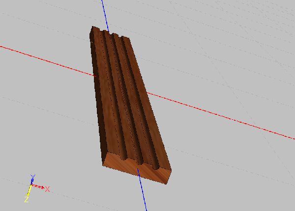

I just did some 3 1/4" fluted moulding based on some stuff that is available locally. I created a profile and applied it to a 3 1/4" stile. It order to make something that is re-sizable I created a faceframe cabinet and then deleted everything except the one stile. I can then attach this moulding to whatever cabinet I want and easily resize it.
If this is something that would work for you I can upload it.

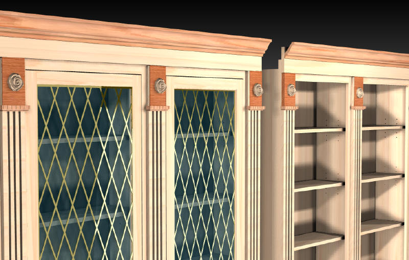

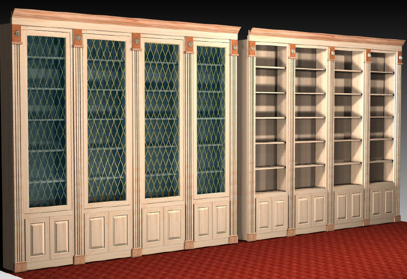

Re: Putting Fluted Columns on a Cabinet
Here is 2 that I did in 2005
Joe Dusel
Posts: 1117
Location: Vista, CA, U.S.A.
Post by Joe Dusel »
Well, it's a good thing that you are better than that now George. 8)
Nice work.
