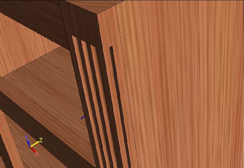

Hey Iain, here is a face frame done as Leo suggests. I then designed a tool to edge cut a flute which followed a tool path created in Contour. The tool path is merely a line drawn on the part. HTH
.125 Edge Flute.zip
(3.17 KiB) Downloaded 414 times
Fluted FF.jpg (59.94 KiB) Viewed 6238 times
