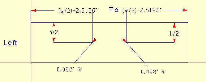

been playing with the constraint manager to drill for some pulls ( I just notice that you cannot associate drill pattern to cabinet pulls). The issue I have is that it doesn't seem that I can get them centered in the drawer fronts. I am attaching the file which. I know that I have too many constraints but that's just to check the result of the formula. Please, check the top drawer, it's where I started from.

Georgi,
What dimension are you wanting to hold between the holes? Right now the dimension is set to 5.039" Is this correct?

Georgi,
Here is an example. Take the width of the Drawer front/2 then subtract half of the distance between the holes.
(W/2)-2.5915

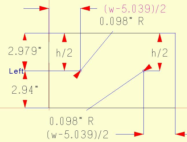

Todd,
I got your idea. The thing that I don't understand is why when I have the height for the wholes set to h/2 when I take constraints from the top and then the bottom shows 0.039" difference (on the picture 2.979 and 2.94 on the bottom). All formulas seem to be right but when you double check they seem wrong. Should I ignore that difference and should I assume that the wholes are centered if I know that the formulas as right?

Post by Damon Nabors »
You are only talking about 5/128". I am not sure but I would thing it would have to do with the dimension increments that ecab works in.

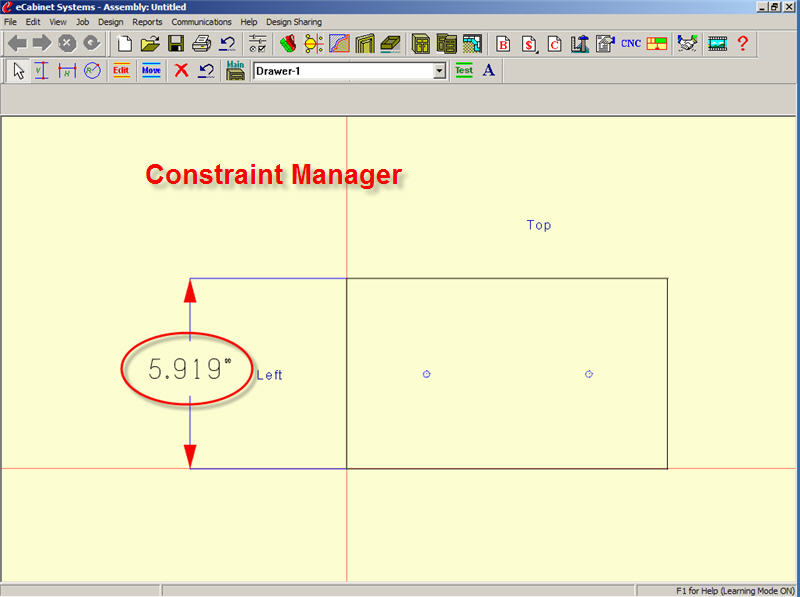

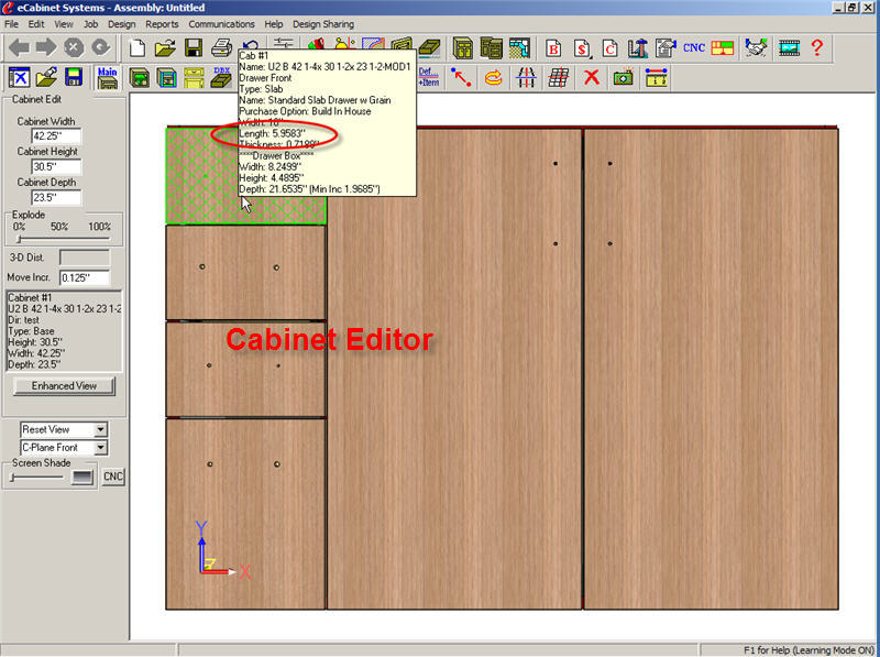

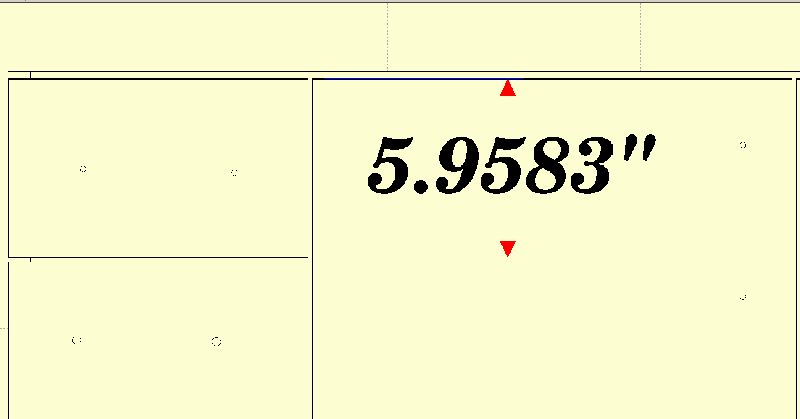

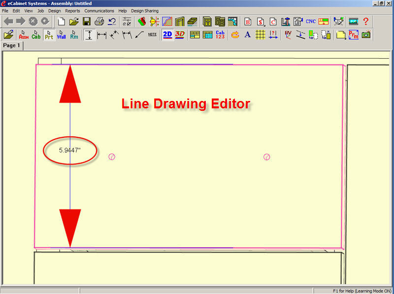

Re: Constraint Manager Problem
The drawer front shows three different dimensions depending on where you are.
Here are three images of the same part from the Cabinet Editor, Constraint Manager and Line Drawing Editor with the dimensions circled. I confirmed that the part has no edge banding either.
Georgi 1.jpg (93.95 KiB) Viewed 9128 times
Georgi 2.jpg (69.96 KiB) Viewed 9127 times
Georgi 3.jpg (54.42 KiB) Viewed 9125 times

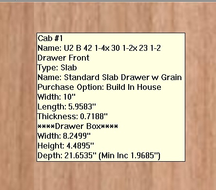

The problem is the edgebanding. If you zoom in real tight and measure the slab minus the edge banding vs the overall size of the drawer with the edgebanding, there is a .0394 difference. The edgebanding has a thickness even though the dimensions of the edgebanding is 0" thick.
Yeah, but there are three different dimensions, not two. Where does the other come from?
Dan, I think you had your measurement in the wrong location. I get the same in LDE and in the Cabinet editor. The CM just doesn't recognise the edgebanding because there is not a thickness associated with the banding. It is set to 0"
measurment problem (2).jpg (59.76 KiB) Viewed 9078 times
LDE 12_2_08.jpg (22.55 KiB) Viewed 9078 times
Damon Nabors
Hmmm...I zoomed way in to make sure I was getting the correct nodes but I guess I still missed. :wall:
