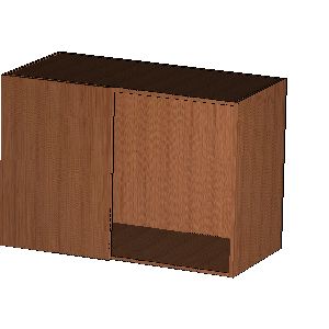

Justin Melhiser
Re: Moving Cabinet
Post by Justin Melhiser »
Sergio
Take a look at this cabinet. It started out as a corner cabinet.
Sergio Fetter
Posts: 92
Joined: Tue, Jan 23 2007, 12:29PM
Company Name: Two Mile
Location: NC
Re: Moving Cabinet
Post by Sergio Fetter »
Hey Justin,
It looks good. Is this a base cabinet or wall cabinet? Can I add frace frame to it?

Justin Melhiser
Re: Moving Cabinet
Sergio
This is a base cabinet detached toe and yes you can put face frames on it.
