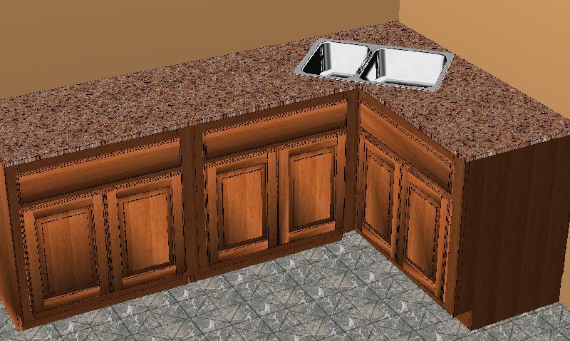

I think this is what you are trying to do. If so, go into the contour mode and draw your lines where you want to cut out the sink and the outer perimeter of the counter top. Then exit out of the closed contour and create your part with "Create part using closed contour" and cut your sink hole out using "cut/pocket using closed contour"
counter top image.jpg (35.45 KiB) Viewed 6083 times

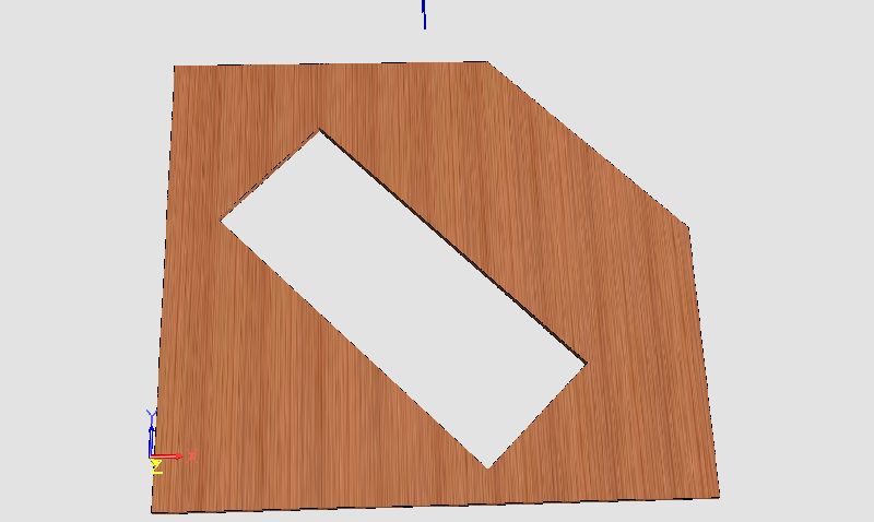

Or like this? Same procedure as above. The only problem with doing it like this, you run out of room for the sink. I have used an L shaped sink in this corner before.
counter top image.jpg (100.44 KiB) Viewed 6073 times

Make sure you have Ortho turned off in the contour mode and you can draw the angled lines.
