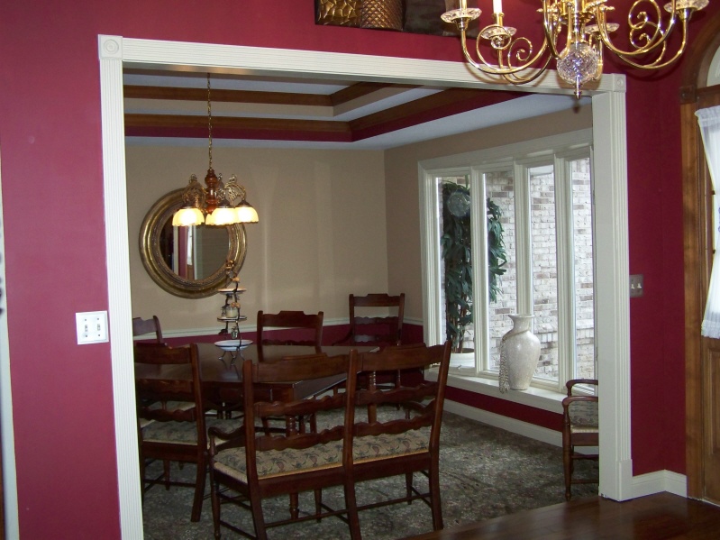

I need to draw this opening with a half wall on each side with columns on top of the half wall going to the top of the door opening. Please see picture
I can create the openong but how do I go about putting in the half walls?
Nanc'y resize.jpg (157.56 KiB) Viewed 2784 times

All you need to do is make the wall as if there were no opening then cut an opening in the wall.

So i have to cut out the part that you see through and leave the part that would be the have walls?
Re: How do you create a half wall
Yep
