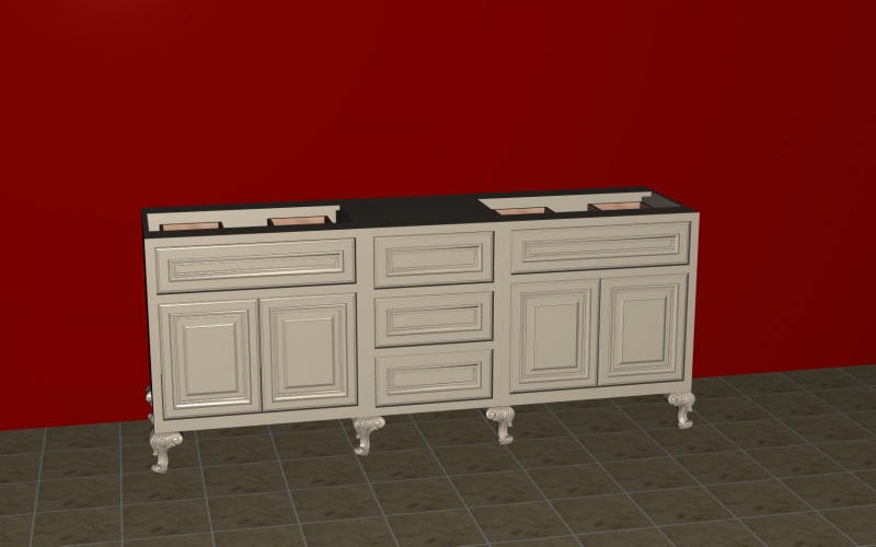

I took a stadard base cabinet removed the toe so I could aply four carved feet( that are user created) applied doors, drawer font and drawers. Saved the cabinet then reopened that same cabinet and I want to move it out of the way so I can use a display panel to put under the cabinet. I am going to use the panel to attach another cabinet ( a drawer bank) then repeat for the other side. So I will have a base cabinet with carved feet then a drawer bank without feet then another base cabinet with feet.

Re: The Cabinet Won't Move
Post by Gary Puckett »
Joe,
Thanks for the tip. I am just useing the display panel on the undernieth side of each vanity to support the drawer bank in the middle.
