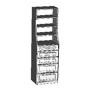

Here is a cabinet that I would like to remove the 4" notch in upper back of each of the panels. I have taken the part into the part editor and with the "geometry cut" removed the curve in the notch corners, but when I try to remove the rectangle notch, this error comes up:
"There was a problem removing this cut. If there's construction near this part, try removing it."
Any ideas if it is possible to remove only this notch without removing all the other geometry cuts as well?

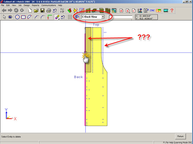

Wow! I get the same message on all geometry cuts, even the fillets.
I was able to remove the notch by switching to back view on the part, but it also removed to back row of shelf holes. It looked really strange when I switched to back view also and when I returned to Main, I got a message like "Violates ideal tenon or dado" but it went ahead and removed the notch.
Something really screwy is going one with this cabinet. You are probably better off saving all of the geometry and recreating the cabinet from scratch. You can reapply the geometry you saved (minus the notch) to the new cabinet.
Also, why not use shelf holes as part of the adjustable shelf instead of creating that many holes in the Part Editor? Figure out how many holes below and above either the top or bottom shelf and apply them to that shelf only.
Here is what it looked like in back view:
