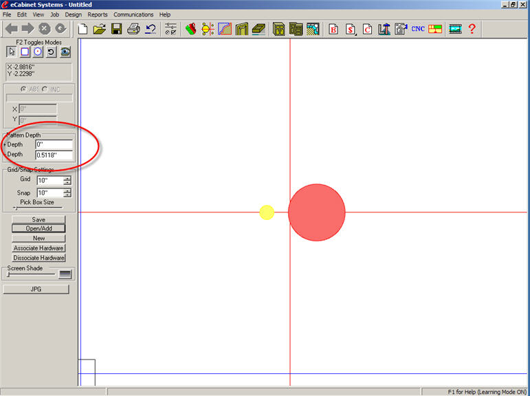

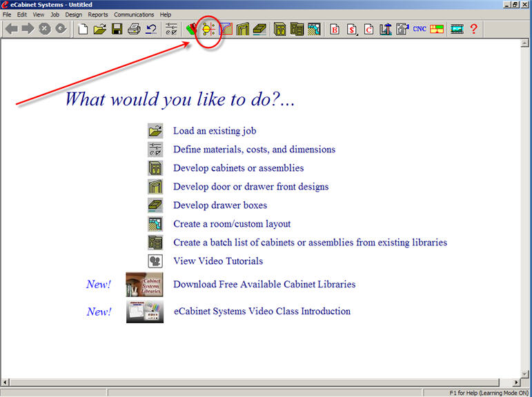

Use the Hardware Hole Editor. After starting the HHE, click the Open/Add button and find the hole pattern you want to edit. When you have the pattern loaded, double-click on the pattern and it will turn red. Now you can set the depth.
