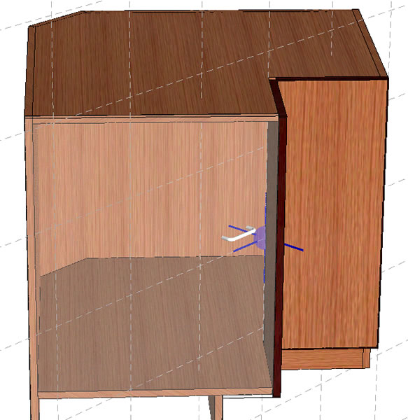

I'm having problems with corner cabinets door handles. I put in the slab double right door on, select handle and place. Handle is "floating" inside of cabinet. Any ideas?
Fred

Can you post the hsf file?

Here is the HSF. I just took the Standard Corner Frameless unmodified, applied doors and placed handles.
Thanks for helping me out with this.

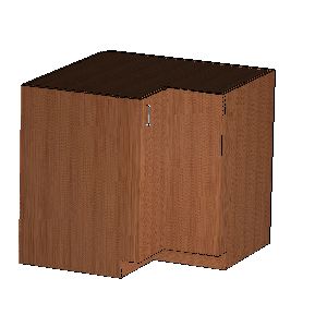

I tried the standard frameless corner cabinet and got the same results. I then went to my own library and brought in the attached corner cabinet and for some reason it placed the pull in the right spot. I don't know what the problem is, but it looks like someone smarter than me should look at the corner cabinet from the standard library and see what is happening.
I didn't make this corner cabinet identical to what you were doing, but it may help.

Thank you very much. We use eCabs all the time but very rarely for presentation. So, to be honest with you I've never put pulls on the cabinets :oops: So.... this could have been a corrupted cabinet all along that I've been using throughout my jobs.

My corner cabinet that I pulled from the "Standard Cabinets" library seems to be just like yours. I'm sure, but there seems to be something corrupted in it. The cabinet that I posted was one that came with the library we purchased from Kerry Fullington back when we first started out. So I don't think that it is just your cabinet that is corrupted.

I have the same problem with corner cabinets.Have ended up manually adding the handles in the CE
