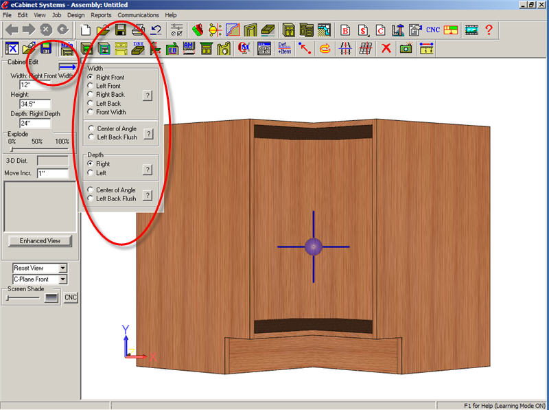

As John said, there are many settings for corner cabinets.
Corner Cabinet Settings are accessed by clicking the blue arrow (by the dimensions area) in the main Cabinet Editor screen.
Corner Settings 1.jpg (85.77 KiB) Viewed 3836 times

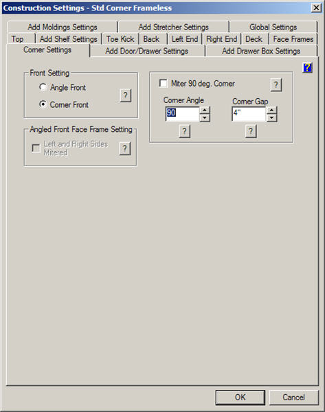

Construction Settings are as John explained.
Corner Settings 2.jpg (37.47 KiB) Viewed 3838 times
