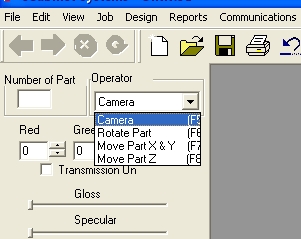

I have been trying to create more display objects and have been getting well and truely getting my teeth into the Display Part Editor and it seems like I have encountered another bug, oops I mean "program limitation". When you load a part it is by default in Camera view and you can move and rotate the part. If I change to Rotate or Move Part X & Y and hold the right mouse key and the Shift key the part should move. In my case it does not, even if I change back to Camera and reset the view I can no longer move the part.

That is just the way it works. When you load just one part in the Display Part Editor it becomes the "Anchor Point". (Use Camera under Operator and the left mouse button if you want to look at all sides.)
If you add a second part in the editor you can then use Rotate part and right click on the part and use the shift key right mouse button combo to rotate that part or Move X&Y. Your Anchor part will never move unless in Camera.

I gave some bad info above. You don't have to use the shift key in the Display Part Editor to move objects. Just set the operator and use the mouse buttons.

Hi Kerry. This is a bug. What I am saying is that a part that moved before in "Camera" does not move at all once you take it into another view and then back to "Camera" I picked this up when I had 2 parts on the screen and nothing moved at all once I have done this. Doing it again now I understand you can also select the part you want to move by typing in the number of the part. In this case it keeps on jumping back to part No. 1 and Part 0 can not be selected.

Select the second object by right clicking on it. When I type in the number it seems to revert back to number 0.
There is a bug in the Display Part Editor that could be affecting you. In the drop down menu where you can choose Camera, Move on XY, etc., there are multiple selections in the drop down. That is once you scroll through the first series of Camera, Move n XY, etc., there is a duplicate set and I believe another duplicate set. I'll call the first set of selections the primary set. If you're selection is not from the primary set, then it does appear to lock up and nothing functions.
This appears to have been fixed in the upcoming version.

That may be the difference. I only get one listing on the drop down.

It may have been fixed in the latest version of 5.2. I was just checking on 6.0. No use hashing over the past if the future has been improved.
