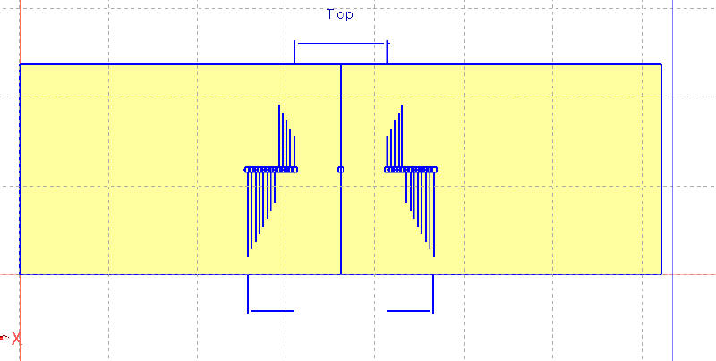

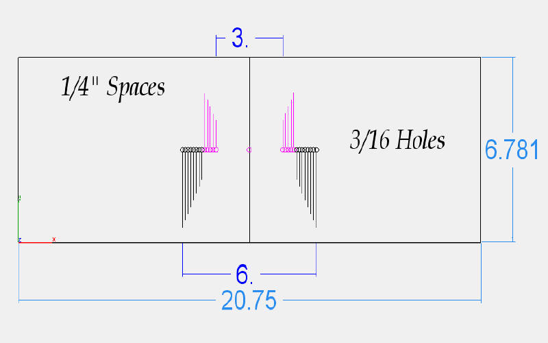

Would this work for anyone
I made a DXF with holes lay ed out every 1/4" on the drawer up to 6" off the center
I started out with a base cab 24 x 34.5 x 24 with slad drawer I set my hole pattern to what I wanted. Then I can resize
the cabinet to the size I want to use.The holes stay in the center of any cabinet size
Try it
Drawer Holes.zip
(64.47 KiB) Downloaded 405 times
Drawer_20.75 x 6.7812.jpg (32.65 KiB) Viewed 5300 times
