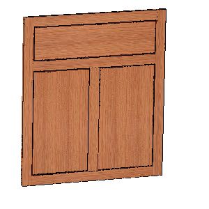

Yes, develop a cabinet with a back made of 1/32" material, and depth of 25/32". Now you have a thin cabinet or "Bar Back" which is re-sizable. You can then add it to a cabinet and save as an assembly, or added directly to a room.

Check out the Construction Settings Gary.

I took a standard base framed cab to the CE I then removed the toe, sides, top and bottom. Changed the back material to 1/32 generic. Removed the adjustable shelf, set the depth of the cab at 3/4+1/32. Then in the DE removed the doors and drawer. Right click to construction settings, set the inset to 3/4 and the gap to 1/8 added the doors and drawer back. Back to main screen, and save. HTH
Re: Face Frame on the back
If you download the Panel Gary, you can then inspect how the settings are configured.
