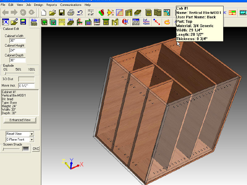

Re: is it possible in ecabinets vertical bin
Mohan,
Do you mean something like this?
Test Bin 1.hsf
(278.02 KiB) Downloaded 641 times

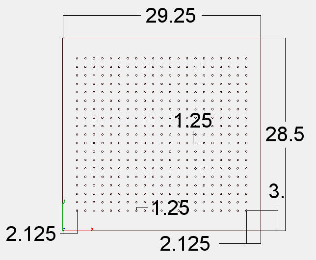

See if the holes work for you

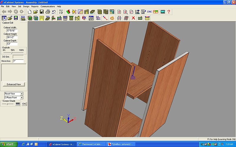

I made 3/16" and 1/4" holes in DXF
Shelf Holes.zip
(87.81 KiB) Downloaded 680 times
.25 Shelf Holes.jpg (47.61 KiB) Viewed 12437 times

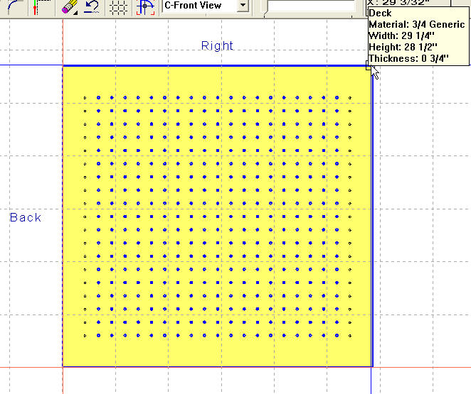

Dennis Englert
Post by Dennis Englert »
While there is not an array or translate function in eCabinets, the Move option provides a similar capabilities since it will copy an entity or entities along with the "move". A method that may make using this feature faster to use is to create a line from the center of the hole that is the length of the spacing between holes. Select the line and the hole to move with the copy feature selected and use the line as the translation points. It's actually pretty quick. Then mirror the holes about a "line" to create the second column of holes. The hole pattern can be copied using the "Create Edges" option in the Contour Mode for the holes needed on the opposite side.

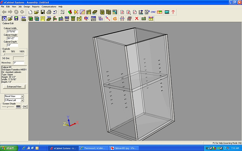

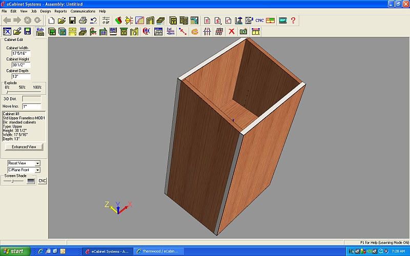

Mohan,
Is this what you are trying to do?

Kerry Fullington wrote:Mohan,
yes kerry exactly this is what i need can u upload the design so that i can compare it with the one what i have done
