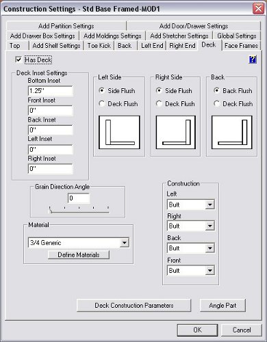

The side cutout that is done when you use the toekick function, is it adjustable? I end up having the face frame hang below the cutout. I need the deck to either be flush or 1/16" below the topside of the bottom rail. and the toekick cutout to be flush with the bottom of the lower rail.
Not like this where the FF is hanging below the cutout. How do I make it flush?

Leo,
Set the bottom inset for the deck to the distance the face frame extends below the notch.
Dave Egnoski
Richmond Cabinet & Millwork
Re: A different toekick question
Leo,
I calculate the deck inset by
width of bottom rail minus thickness of deck material equals Deck Bottom Inset

I'll try that Dave, I'd been playing with the toekick settings, not the deck settings. They sure can make it difficult sometimes. Thanks. :beer:
