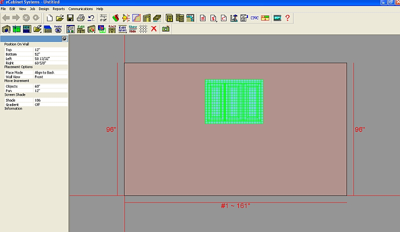

This is what I get with my cabinets.

Re: Moldings and measuring
Leo,
Upload your job with the cabinets in question. I don't think eCabinets ever measures to a molding in custom layout.
There has to be another problem. Angled walls are sometimes the culprit.

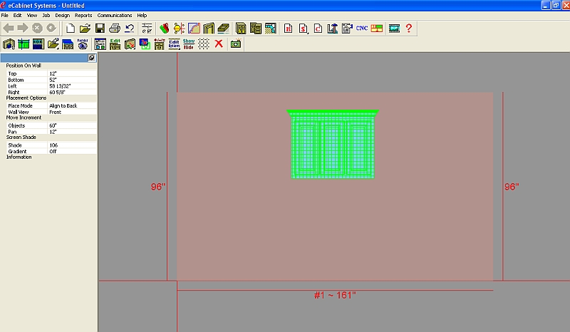

So I took off the molding and it measured proper. Put it back on and it was screwy again. Something to do with the molding.
Leo,
You are correct it is including the molding. I think it has something to do with the fact that it is an assembly. A tall cabinet with moldings behaves properly.
Maybe the eCab guys can shed some light on this.
For right now I would do as suggested above and place the assembly in the room without moldings then add the moldings when the assembly is in place.
Leo,
After thinking about it I would bet this is proper for an assembly to take in the size of moldings. In an assembly you could place a part floating in space a foot to one side and that would become part of the overall size of the assembly.
to get past this you can place moldings after placing the assembly (but note that if you move the assembly it will start to behave as one or you could just use a base and an upper to make your tall cabinet and place them in the room as such.
