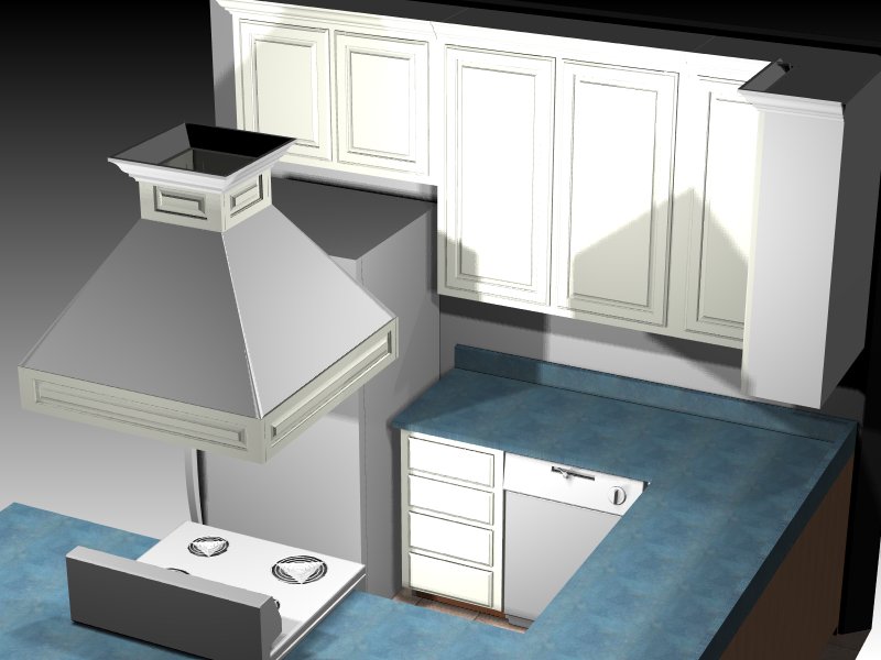

Here is one I did recently. It is some drawer fronts and display panels.
Hi Dennis
Here is a 30\" and a 36\" Inland hood that you can play with I would keep it
in assemblies (It has alot of parts)
