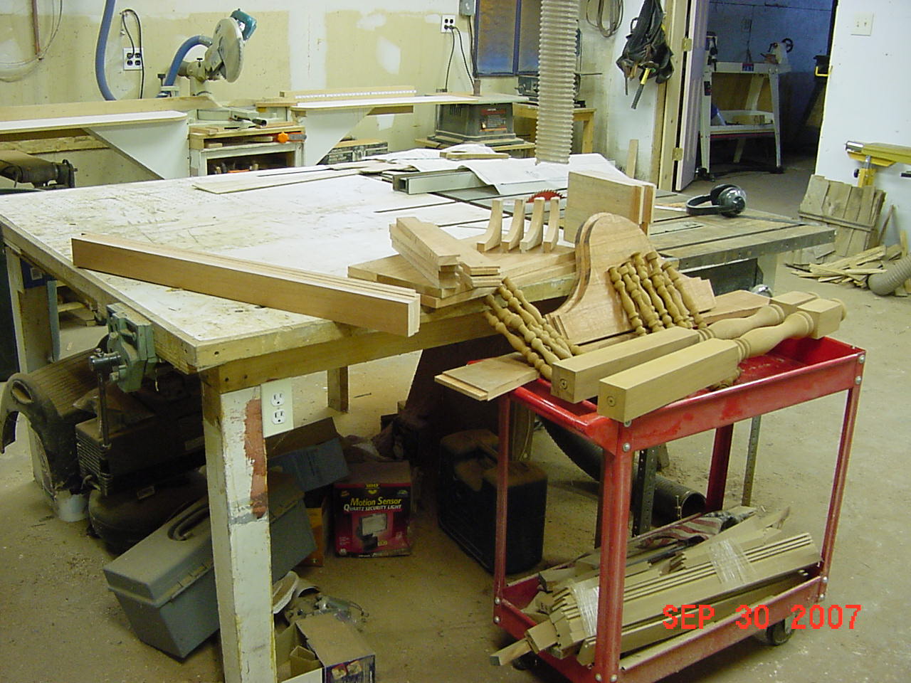

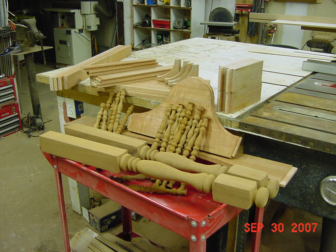

I have to go out to the shop now. I will play with it later.One thing I have to do today is the cradle it has been sitting for 2 weeks
Thank You Mark
9-30-07 Sunday.JPG (203.78 KiB) Viewed 8026 times
9-30-07 Sunday (2).JPG (207.61 KiB) Viewed 8026 times
