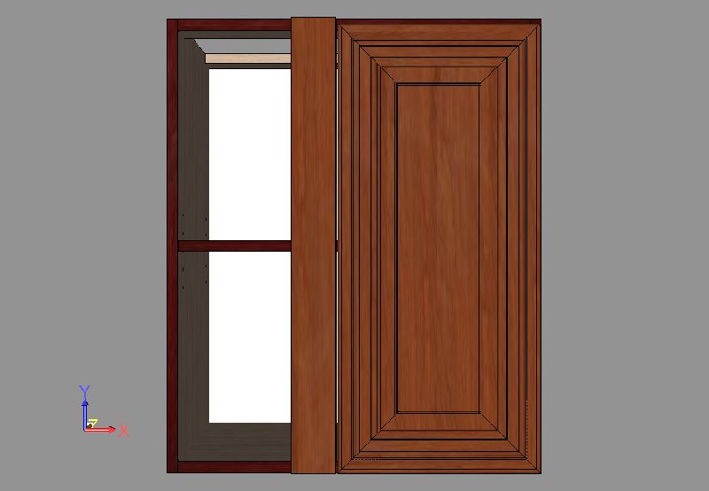

A frameless blind basecab is the today's challenge cup, and the file is attached.
The door has a 1/8" margin between itself and it's "stile" on the left, which is the spec for the Blum blind corner hinges used there.
Bottom reveal is zero, top reveal is 3/8", R side reveal is 1/8".
Take the cabinet, remove the door, and replace it so that you get the same reveals. It is a "faceframed" cab, with the only part of the faceframe being the 4" "stile" the door is hinged to, thus the door is inset 3/4".
I'll start the timer when you've loaded the file.

Gene,
What seems to be the problem? Once you save your file with the door parameters there is no problem changing doors.

I did it before the last post.
3/4 inset
+1/8" Hinge side gap
-5/8" Open side gap
-3/8" Top gap
-3/4" bottom gap
I still don't know what you are trying to get at.

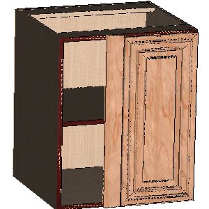

Not sure what the problem is, changed doors for ya
iiii.hsf
(400.02 KiB) Downloaded 399 times

Took about 5 minutes because I didn't get the constructions settings on the first try.
Hinge side gap: -.75"
Open side gap: .125"
Top gap: -.375"
Bottom gap: -.75"
Door inset: .75
