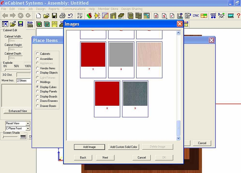

Thanks, I copied the picture and when I went to add a new image in the material section no image came up. Any ideas why no image came up?

I am not sure why the images will not show up for you ?
The only thing I can suggest is to add the images to your material folder with e-cabs shut down and see if that works.
Find your ecabs folder than your materials folder add a new folder in there called beadboards, open this folder and copy and paste the beadboard images to this folder.
Close down your folders and fire up ecabs. Settings/Preferences, Define Stock Materials, Sheet Stock , Select Image, Beadbords, (You created this folder earlier) The beadboard images should now be in here.
Good Luck
