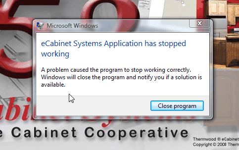

Have been using Windows Vista Business for over a year with absolutely no problems.
This morning, I could not open it.All I get is,"E-Cabinet Systems Application has stopped working."I was right in the middle of a bid,so where do I start?

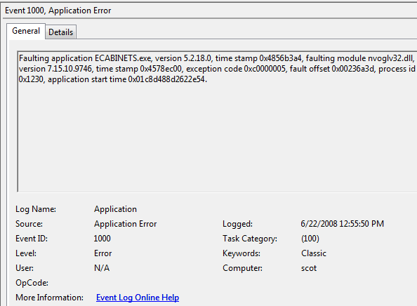

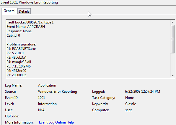

    At this point, everything seems to have installed OK. Also, on the ecabinets shortcut, it does have the shield, implying that it is being run as Administrator. I checked the properties to confirm this. Once I run ecabinets though, it shows the ecabinets splash screen and then fails during startup. I have included the screen capture of the message that occurs during startup, although that is unlikely very helpful. There were also 2 events added to the event viewer of which I have also attached screen captures. Hopefully these shall be of some help. The event 1001 message was too long for a screen capture, so here is the pasted text from the dialog window containing the message:
    Fault bucket 808526717, type 1
    Event Name: APPCRASH
    Response: None
    Cab Id: 0
    Problem signature:
    P1: ECABINETS.exe
    P2: 5.2.18.0
    P3: 4856b3a4
    P4: nvoglv32.dll
    P5: 7.15.10.9746
    P6: 4578ec00
    P7: c0000005
    P8: 00236a3d
    P9:
    P10:
    C:\Users\sacree\AppData\Local\Temp\WERA7B4.tmp.version.txt
    These files may be available here:
    C:\ProgramData\Microsoft\Windows\WER\ReportArchive\Report10751880
    Thanks for any help, Scot Acree
    Event Error 2
    Event Error 2
    First Event Error
    First Event Error
    Splash Screen Error Message
