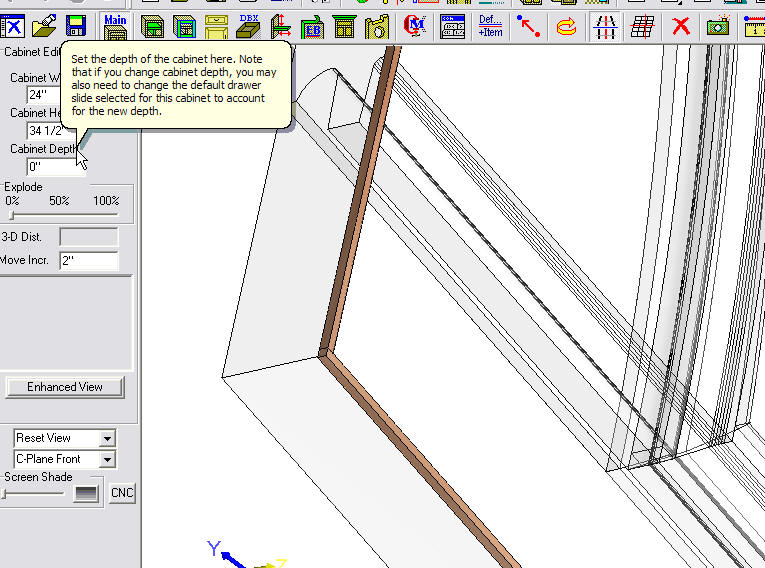

I call this my work around
I make my cabinet 24 x 34.5 x 0
R & S 1/16" by 1/16"(no overlap)

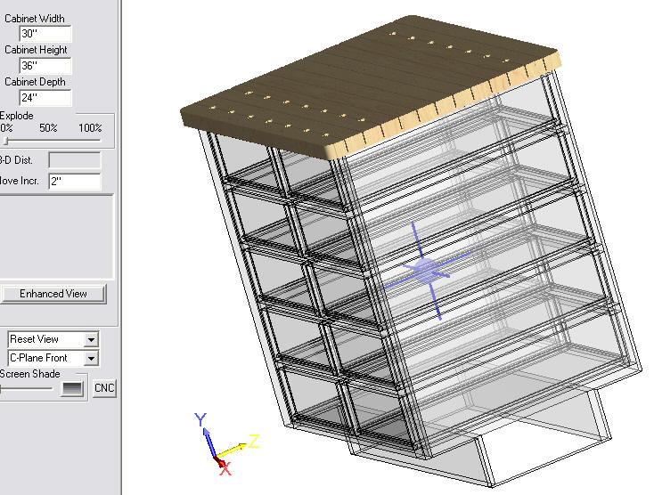

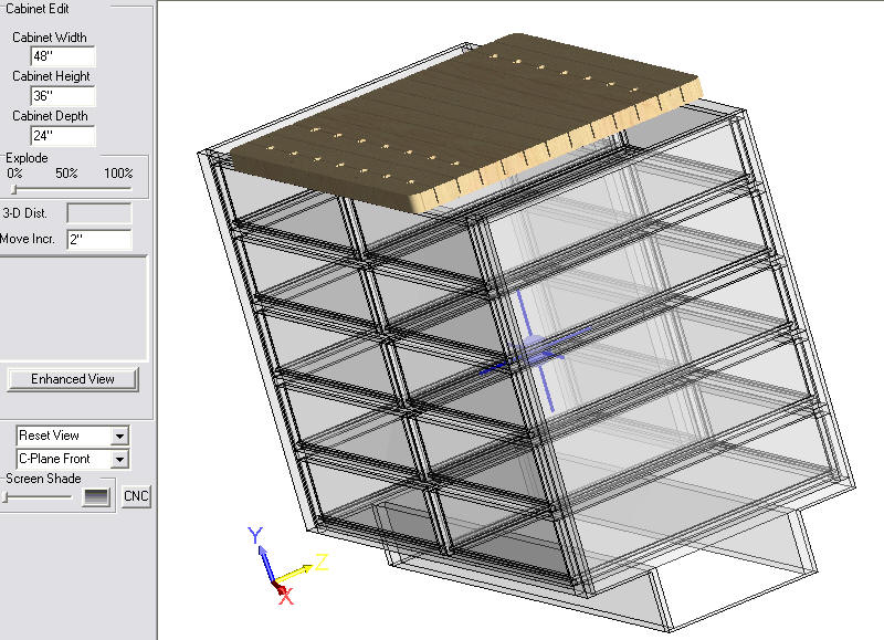

Here is something you can play with
Here is a work bench I made up about a year an 1/2 ago
I made it with Stretchers
It can be resized
My work top can not be resized
Work Benchs.zip
(667.02 KiB) Downloaded 387 times
30 x 36 x 24 2 Sided Drawer Cab.jpg (92.67 KiB) Viewed 4897 times
48 x 36 x 24 2 Sided drawer Cab.jpg (102.99 KiB) Viewed 4897 times

You can load a cabinet into the editor and remove everything, and yes the door will disappear, leaving a blank screen. But the "cabinet" is still there, and it is the size specified in the dimension boxes. Set all your overlays/insets so that the size you specify is the size of door that you want, go to the door/drawer editor, and click in the middle of the screen. The green highlight will light up, and you can add a door ... end result: a cabinet that is simply a resizable door.
I know this doesn't exactly help you Forrest, but I think this is what George is after.
