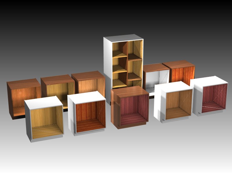

Cabinets White on out side grain in side
The Cabinets acn be resizes width and height. Insides are made of stretchers T_1/64"
they will not work on the depth. You would have to change the depth of the stretcher
1-9-09 Resize Cabinets.jpg (44.76 KiB) Viewed 3744 times

George that's looking great but I would rather get it the other way around. While on the inside and then any grain on the outside.
Can it be done? Again being able to resize the width.
Re: Cabinets White on out side grain in side
The depth you can not change. The size of the whiteboard has to be changed before you change the depth
The width and height can be change to any size

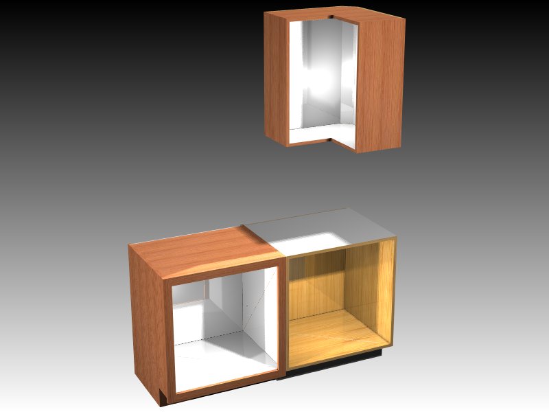

Corner Cab_1.jpg (99.12 KiB) Viewed 3674 times

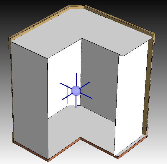

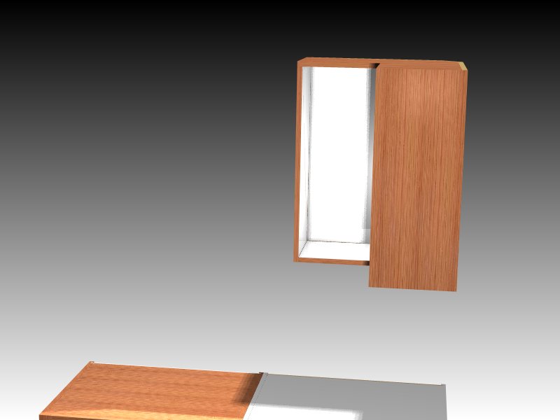

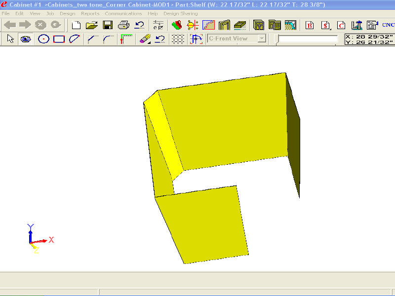

Corner Cab liner the liner can not be resized. You would have to make a new liner for each corner cabinet
Corner Cab_4.jpg (57.43 KiB) Viewed 3662 times
Corner Cab_3.jpg (40.2 KiB) Viewed 3662 times
Corner Cab_2.jpg (34.18 KiB) Viewed 3666 times
