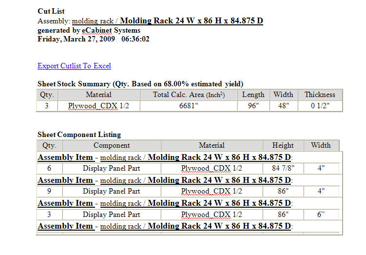

Cut List
Cut List

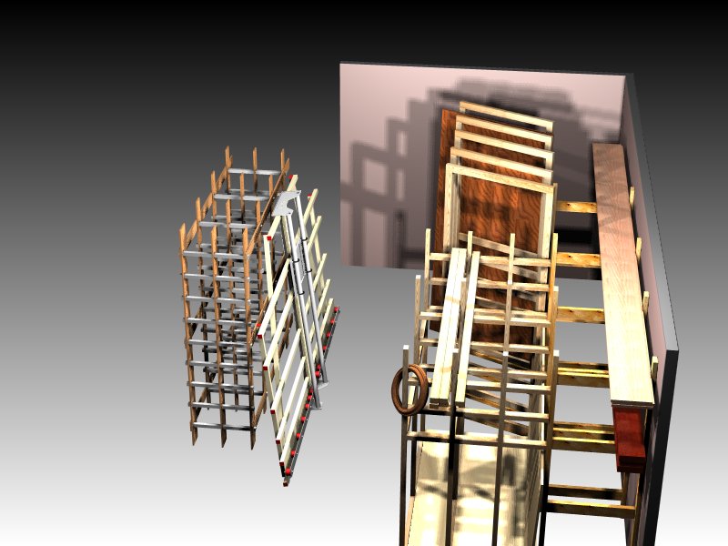

I made a molding rack for our shop.
Cut list tells me 3-Sheet of 1/2" plywood

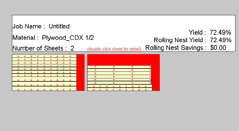

Batch material tells me 2- sheets
The batch is right

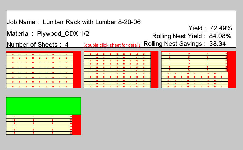

Here is another batch
Material List_4=Sheets.jpg (86.38 KiB) Viewed 6499 times
Material List_2=Sheets.jpg (52.53 KiB) Viewed 6500 times
Cut List.jpg (100.36 KiB) Viewed 6499 times

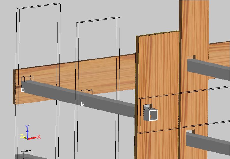

Here is the Rack in ZIP File
It is the rack back of the panel saw.
Made of 1/2" plywood and exter Plasic Balusters
How the rack locks.jpg (53.19 KiB) Viewed 6490 times

Re: Cut List
The cut list BEFORE nesting is based only on total square inches and cannot be relied on for accuracy. ALWAYS nest before producing a cut list.

Re: Cut List
Maybe the cut list should have a disclaimer to that effect if it is produced pre-nest?
Re: Cut List
I am not sure what I did it still comes up with 3-Sheets cut list
Re: Cut List
Did you run the cut list from the nest?
Re: Cut List
I gives 2 sheets for me, both before and after nesting.
Re: Cut List
Thank You Dan
So I get the right cut list just when I am in the batch.
I was thinking if I batch it and came out into Cabinet Editer I would get the right cut list then
Re: Cut List
Batch it, nest it then create the cut list while still on the nest screen.
