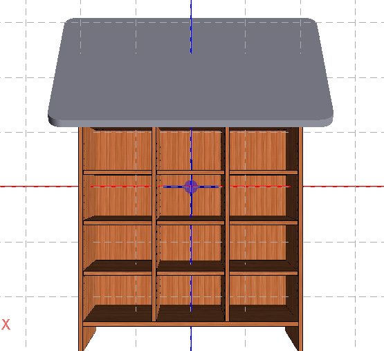

On cabinet with a sloped top, is there a way to have the counter follow the slope? I've attached a screenshot of what I came up with, using the Countertop Editor. Sorry for the extremely basic drawing, I rarely use this area of the software (or the Countertop Editor...) Thanks.

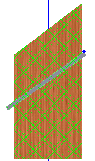

I may not be going about this right, but I brought the display cube and cabinet together into the Cabinet Editor. The screenshot shows as far as I was able to get. My plan was to use the 'Align Items' feature. I was able to select a node on the display cube, but not on the cabinet (trying for the upper corner), for some reason. Not sure why.
Re: Sloped Counter
Nat,
Double click the cabinet to select it and the align tool will work. The cabinet will have a green outline not a hatch pattern. It looks like you have just selected an end.

Thanks Kerry, that did it. -Nat

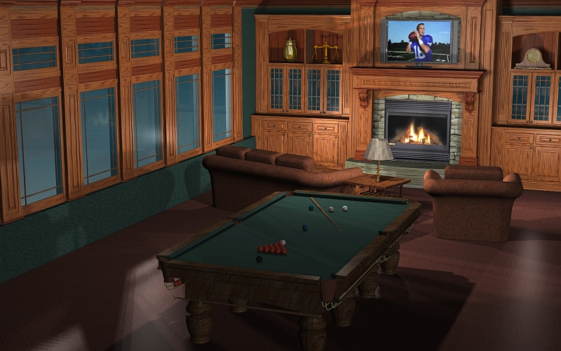

Extremely nice work Kerry. I'm continually amazed by what you're able to do with the software

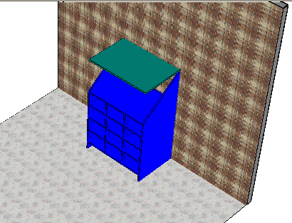

In stark, stark contrast here's where I'm at:
Looks like there's still quite a bit to learn! Thanks again for the help.
